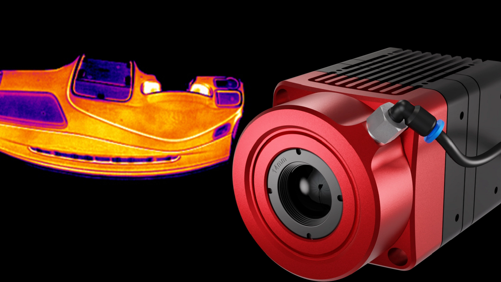

AT Sensors has introduced the IRSX-2, a stand-alone infrared camera designed to continuously monitor temperatures, analyze thermal data and communicate results directly with industrial control and visualization systems.
The camera combines infrared temperature measurement with integrated image processing, allowing temperature deviations to be detected within the process without requiring additional external processing hardware or software. Applications include thermal inspection of electronic components, early fire detection, industrial plant monitoring and quality control.

The IRSX-2 features a more compact housing than its predecessor, with design changes aimed at continuous industrial operation. The camera has an IP67 rating and uses M12 cable connections for industrial connectivity. An optional air-blow device is available for applications where dust, moisture or other contamination could affect the camera or its optical path.
