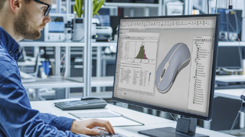

One of the most common mistakes in tolerance analysis is treating an assembly as a simple stack-up of dimensions without considering how components are located, constrained, and assembled in 3D space. In real manufacturing, variation in reference surfaces, locating features, and assembly sequences can significantly influence the final product. Ignoring these factors can lead to inaccurate predictions of gaps, flushness, and dimensional performance.
With a specific assembly simulation software like 3DCS, engineers can simulate the assembly process and account for the impact of component variation and assembly constraints, providing a more realistic understanding of how variation affects the finished product.
