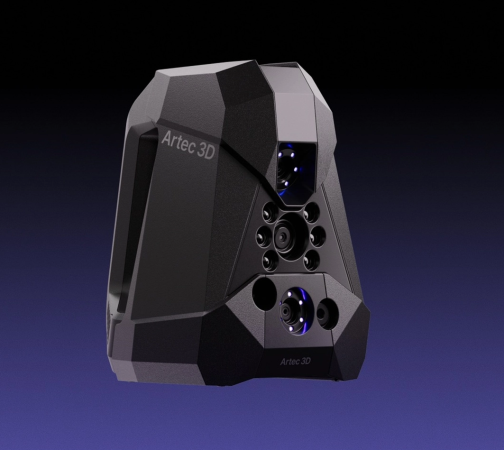

Artec 3D has announced the launch of Artec Neo, the first tolerance-driven wireless 3D scanner, unlocking a new approach to dimensional control and reverse engineering.
Artec Neo delivers metrology-grade accuracy of 0.025 mm and volumetric accuracy of 0.025 mm + 0.035 mm/m where the design demands it, while capturing full-color 3D data of the entire part at up to 0.05 mm resolution.
Artec Neo introduces an entirely new 3D scanning approach. Instead of treating every surface as equally critical, the device reserves metrological accuracy for functional features. This is what Artec calls tolerance-driven 3D scanning: it gives users full flexibility in how they apply targets and delivers metrology-grade results with far greater efficiency.

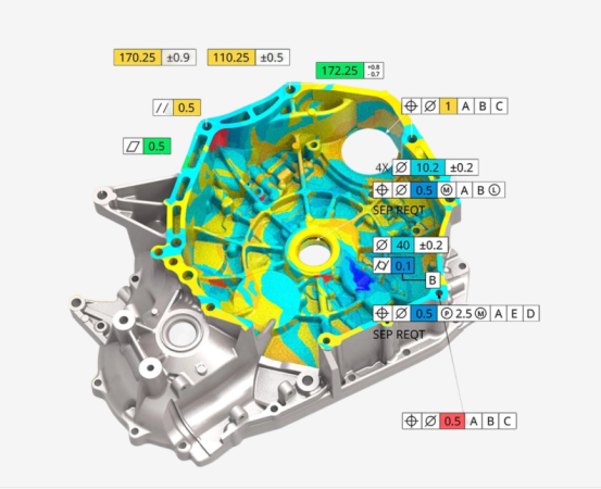

Measure to Design Intent
Modern engineering is built around a simple principle: measure the surfaces that determine whether a part will function as designed. This idea lies at the heart of GD&T. Engineers use dimensions and tolerances to communicate design intent — which features are critical to fit, alignment, sealing, and function, and how tightly each must be controlled.
Until now, metrology-grade 3D scanning has treated all surfaces alike: conventional laser workflows rely on targets across the whole part to maintain guaranteed accuracy, including areas with no critical requirements. That makes inspection and reverse engineering unnecessarily slow and expensive.
Artec Neo flips the script: metrology-grade accuracy follows design intent. This is made possible by Artec’s proprietary blue-light optical system and a single hybrid tracking architecture. Artec Neo uses targets only as metrology anchors — delivering 0.025 mm accuracy where tolerances are critical. At the same time, AI algorithms maintain tracking across the rest of the scan through geometry, texture, and color. There is no switching between separate scanning technologies or datasets.

Powered by Artec Studio, Artec 3D’s flagship software for 3D data capture and processing, Artec Neo delivers data ready for reverse engineering and inspection. The platform includes all the essential editing tools, alongside integration with SOLIDWORKS, Geomagic, and PolyWorks for more advanced tasks.
