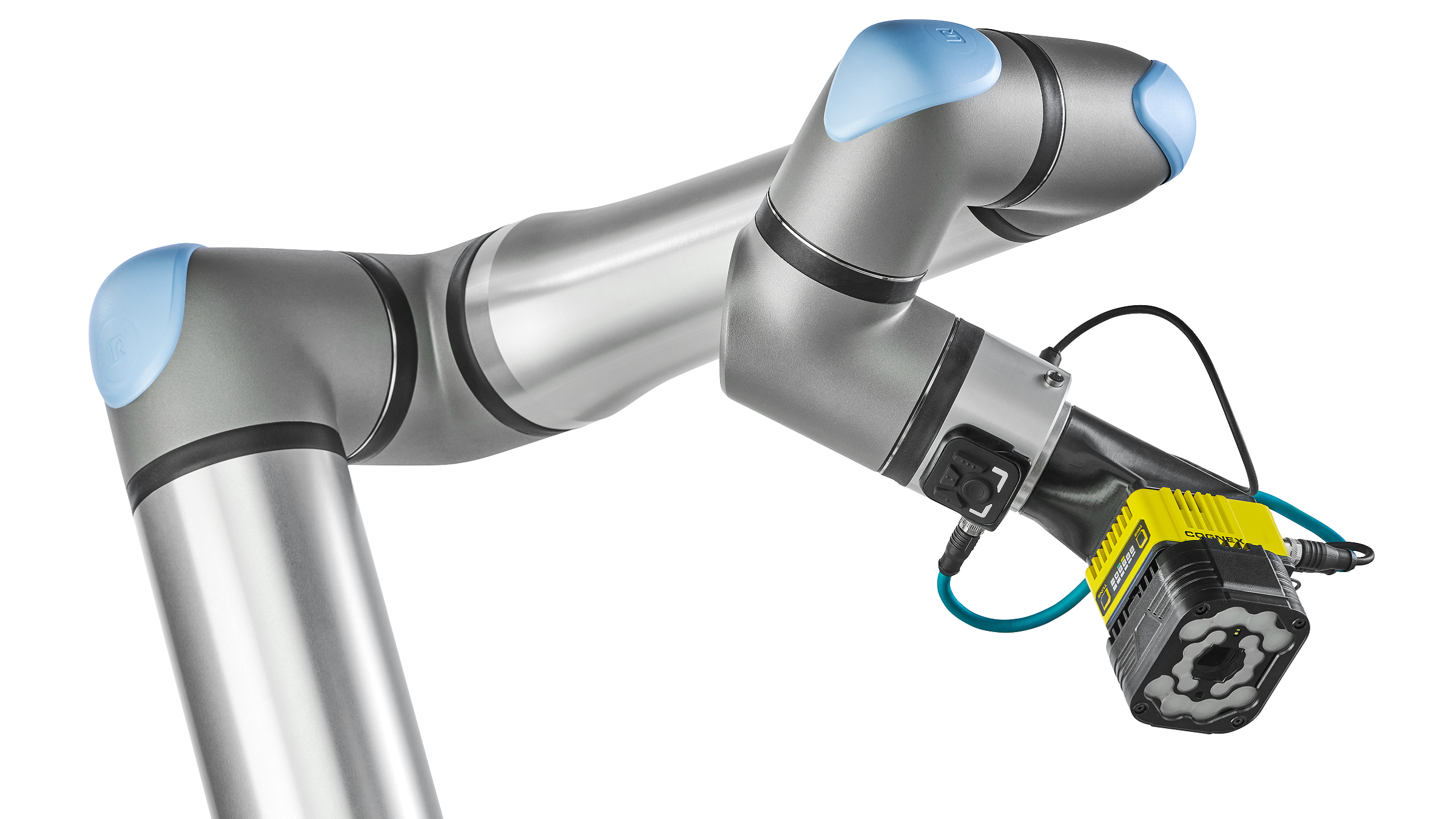

Robot Arms with AI-ready Tool Flange: The Gen 7 platform adds three new robot arms: UR10g-1750, UR17g-1300, and UR18g-950, named after their payload (kg) and reach (mm), joining the e-Series and UR Series lineup.
The new g-Series tool flange enables the vision and sensing needed for AI models to run in real time with the robot, delivering data, power, and safety directly to the tool flange. This eliminates cabling complexity and makes it easier to connect cameras and high-bandwidth sensors, which is critical to advanced automation and physical AI deployments.
