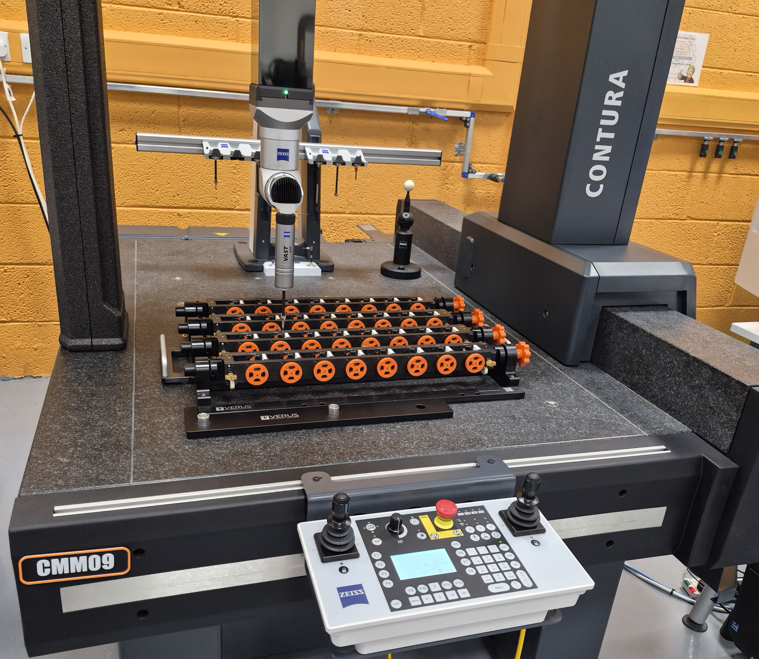

A: Andrew Hodson: Wherever the CMM sits, the fixture has to match the client’s sampling and production rates. If you can only put one or two parts up at a time, you won’t keep pace with a high-volume moulding line. That’s why we build 24-, 32- and 64-station fixtures that fill the full stage of a large CMM, then automate the measurement process to maximise throughput. On a fixture like that, every station has to hold the part identically, or the data isn’t repeatable. Trade shows tend to feature engine blocks and turbine blades. Multi-station fixturing for flexible, plastic and thin-walled parts in medical, pharma and personal care is a different discipline, and it’s Verus’s specialty.

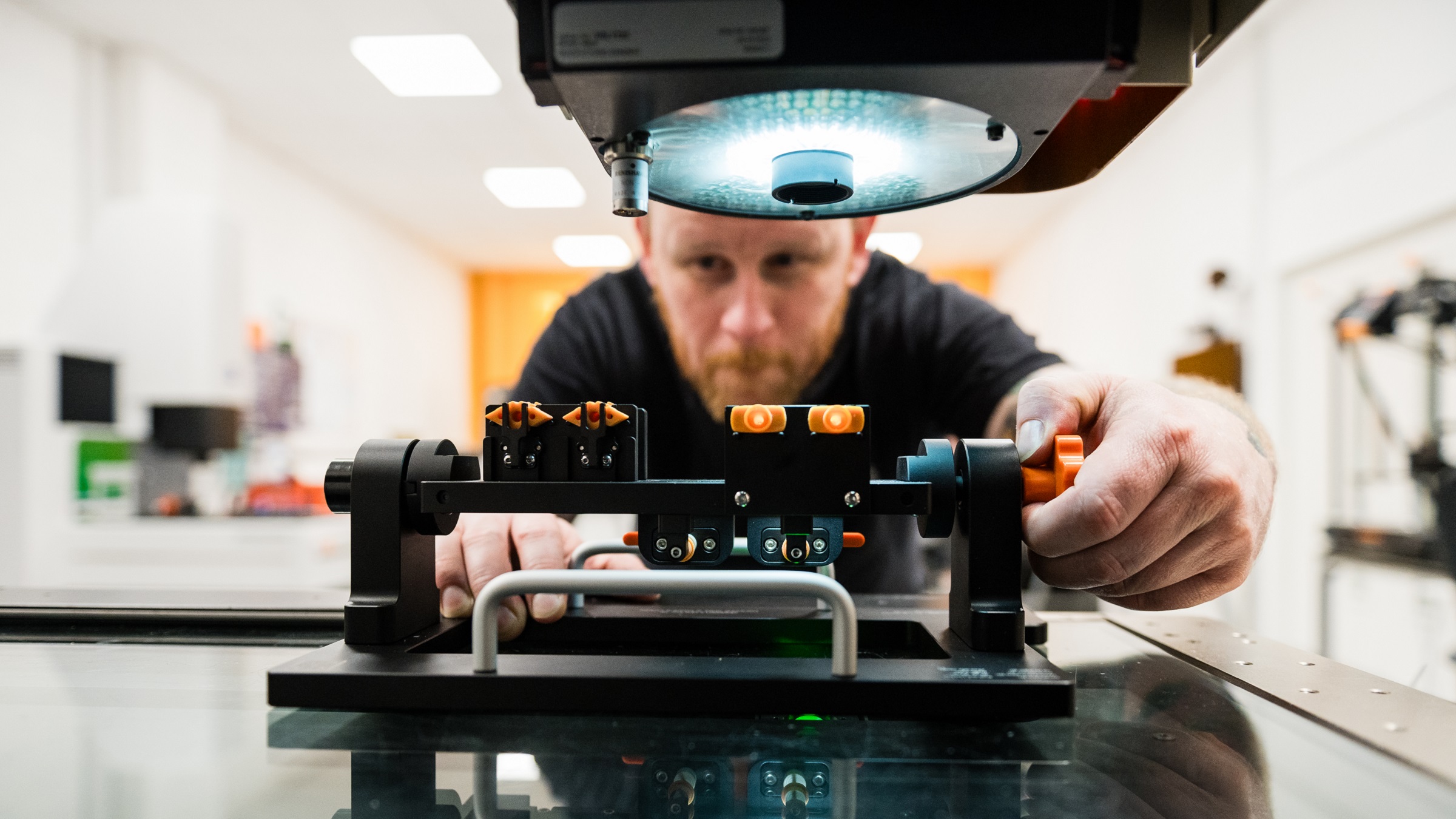

A: Michael Nugent: A manufacturing fixture exists to hold the part rigidly while it’s machined. It doesn’t have to consider whether it’s influencing the part’s geometry. A metrology fixture exists to hold the part without influencing it or distorting it, so the part can be measured repeatably.
A: Andrew Hodson: In some metal-cutting operations the machining fixture simply moves to inspection with the part, so the two get treated as the same thing. Many of our clients’ parts are moulded. They’re easily influenced, they warp, they move with temperature and humidity, and they vary legitimately within their production tolerance. A Verus fixture lets the component float within its tolerance band without influencing the measurement. As long as the part is in specification, the fixture keeps working.

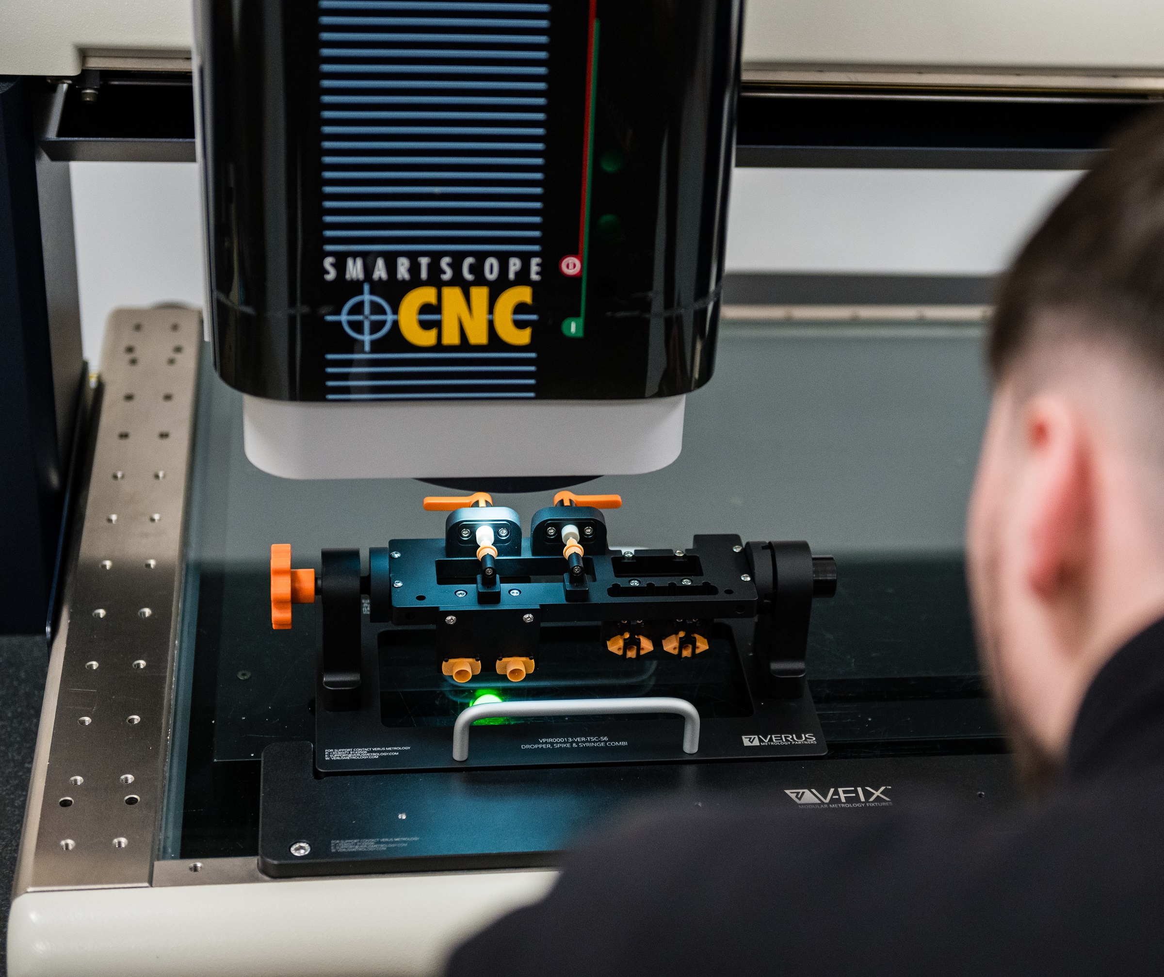

A: Andrew Hodson: It comes down to how we design and tune our fixtures. We use our own methods and processes to let the component sit in its natural state and vary within its validated manufacturing process window. We don’t use hard clamping, full-form nests or friction fits, because each of those changes the geometry you’re trying to measure.
The benefit is that the data tells the truth. Because the fixture isn’t pushing the part into shape, a genuine moulding or process effect shows up in the measurements straight away, instead of being masked by the fixture.
A: Michael Nugent: Put simply: a Verus fixture holds the part. It does not locate it, and it does not influence its geometry.

A: Andrew Hodson: Our fixtures are “load once and leave”. Rotating stations give full access, so the part is never moved from one fixture set to another to finish its measurements, and the same fixture can run on a vision system or a CMM. Every extra load is a chance to bend a thin-walled part or warm it with your hands.

Michael Nugent: It should be front and centre. If you’re going to measure parts, the CMM decision, not just size but type, software, probing and optics, has to be made with the fixture in mind. We work in the world of 8-, 16- and 32-station fixtures. If someone has a part the size of your fist and wants 32 stations, a small machine simply won’t take it. Too often the budget is set too late.
Andrew Hodson: The right time is when the production method is chosen. Once you know the volume, the mould cavitation and the cycle time, you know your inspection load. Produce 10 million parts a year with a given sampling plan and you might need to measure 20,000 of them. That decides whether you need vision, a CMM or a multisensor system, and at that point you need to decide how you’ll hold the part. Fixturing should be specified alongside the mould order.
Get it wrong and the consequences are real. Buy a machine that’s too small and you can’t fit a fixture with enough stations to hit the sampling rate. You end up buying a second machine, which is great for the machine supplier but may never have been needed, or manufacturing under concession because you can’t meet your sampling requirements.
