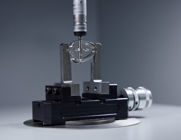

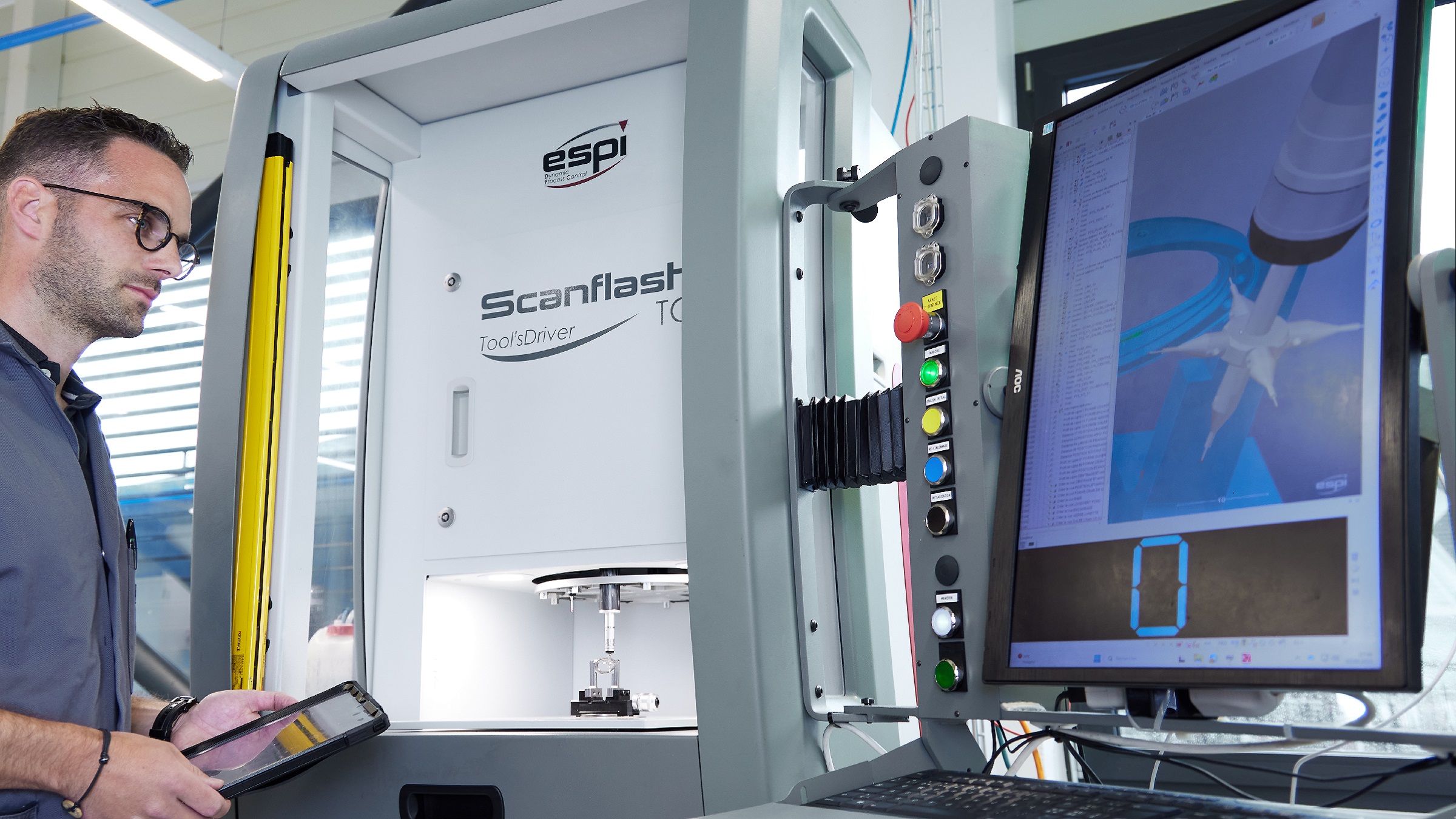

The first step was to invest in a Scanflash TC three-dimensional workshop measuring machine, supplied by ESPI. Designed to operate in a production environment, this CMM stands out for its speed and accuracy, which are essential criteria for Bvlgari.
The machine allows checks to be carried out during production, several times a day, and meets internal requirements in terms of responsiveness and rigour. But very quickly, a limitation became apparent: “The programming time was enormous, the risk of collision was high, and programming complex shapes was virtually impossible,” explains Mathias. The machine therefore remained largely under-utilised.

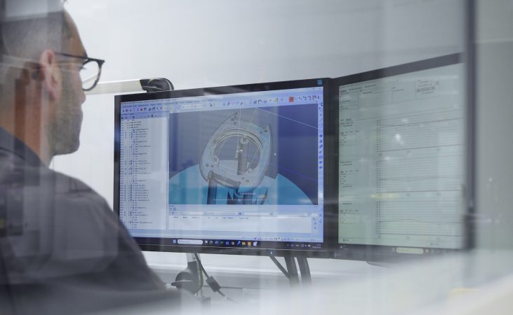

Several years of joint development between ESPI and Metrologic Group, combining the power of Metrolog X4 with the speed of the Scanflash machine, have resulted in the launch of a high-performance tool that meets complex programming needs.
In 2022, an update to the Scanflash was offered to Bvlgari, now incorporating Metrolog X4 as the control software.
“From the very first demonstrations, we saw how much this software would increase our flexibility and speed,” says Mathias. Integration was quick and easy: “Within a week, the machine was running with Metrolog X4.”
For Alexandre Goupy, Sales Manager at Metrologic Group, this project perfectly illustrates the complementary nature of hardware and software: “The machine alone was powerful, but without a suitable interface, it remained underutilised. Metrolog X4 provided the ease of programming that was lacking. Today, they can’t do without it.”
Samuel Jabès of ESPI explains that ”not only does the machine offer unrivalled inspection efficiency in terms of dynamic performance, but thanks to MetrologX4, it is also easy to program. The advanced features of the software have enabled the Bvlgari teams to appreciate the programming and start trying new things by pushing the limits of the machine.”
In addition, offline programming via Metrologic Group Silma software now allows the quality team to create new programs while the machine remains available for production. The time savings are considerable, and operators are never interrupted.

The benefits are clear. Inspection time has been reduced sixfold. The number of dimensional problems detected downstream has decreased significantly. Use of the machine has been extended to internal analysis and other departments.
“We now inspect 95% of our box production with this machine,” says Mathias. “Our analyses are more reliable and better understood, and I even have more internal requests to carry them out.”
