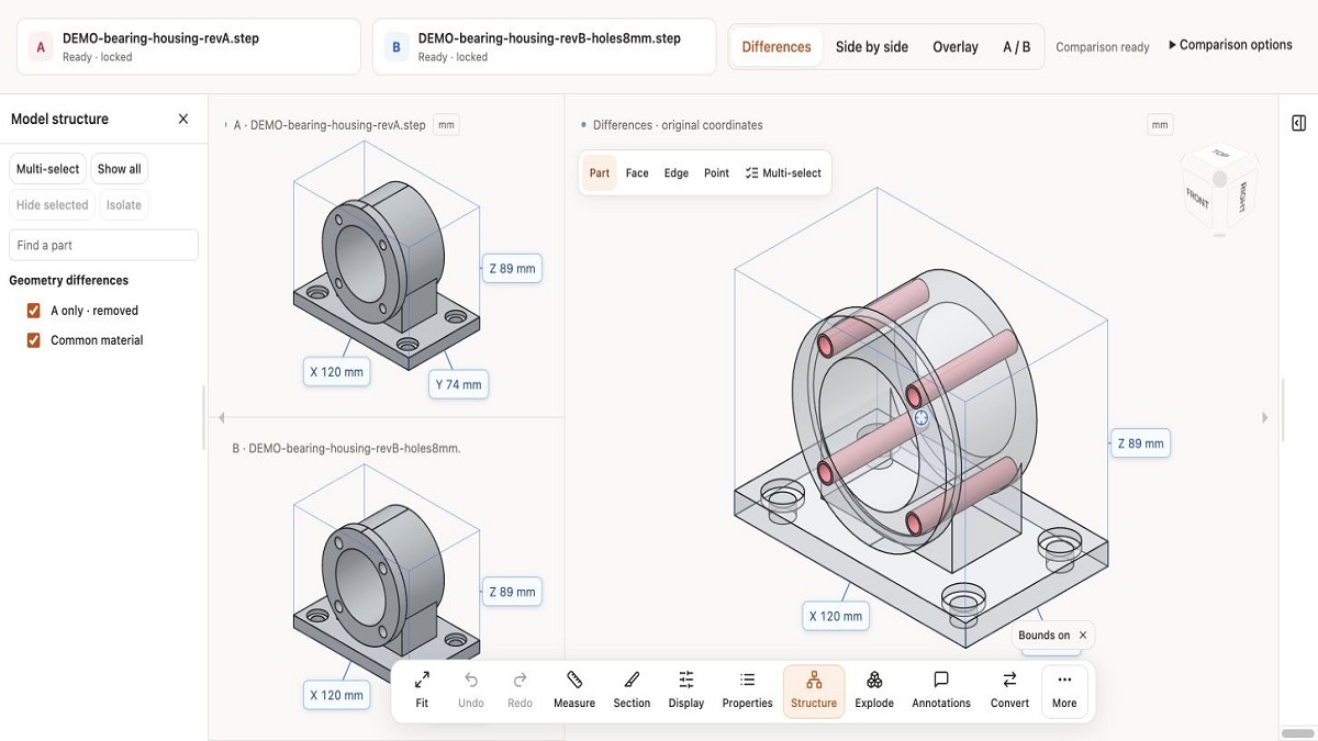

Locate The Changed Feature
Our synthetic bearing-housing example keeps a 120 × 74 × 89 mm exterior envelope in both revisions. Four holes in the front flange change from a nominal diameter of 6.4 mm to 8 mm, while the original source coordinates remain unchanged. These are the flange holes around the central opening, distinct from the base mounting holes. The example supplies no tolerance, hole-depth or surface-finish requirement.
In the CADProps comparison shown above, red A-only material marks material present in revision A and absent in revision B. Transparent grey shows common geometry. This directs the reviewer to the enlarged holes despite the unchanged envelope. The image is a view of nominal CAD geometry; it contains no measurement of a manufactured housing.
CADProps’ comparison tool supports A-only, B-only and common solid differences for suitable valid closed STEP pairs, subject to current processing limits. Other supported 3D inputs provide visual comparison, and mesh results are approximate. The tool preserves source coordinates and performs no automatic alignment. Selecting files starts temporary server processing, so teams should check their data-handling permissions before using it for controlled models.

Once the changed feature is located, connect it to the released drawing or approved product definition and the relevant entry in the existing inspection plan. Check what those controlling sources say about the nominal target and associated requirements. Review datum relationships where relevant, without inferring a datum change from the colour of a geometric difference.
For the four flange holes, the nominal diameter change creates a specific review item. It does not supply the allowable size range, geometric controls, inspection method or acceptance decision. Those details must come from the applicable requirements and the organization’s established process. The engineer can then assess whether the current plan remains suitable or needs revision and further validation.
