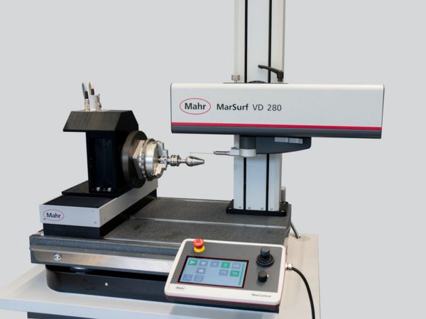

Mahr has introduced the MarSurf CNC modular Evo, an entry-level CNC measuring station designed to provide a step-by-step route from manual or semi-automated surface measurement to automated inspection.
The new system is intended to bridge the gap between conventional shop-floor measurement and larger, fully automated inline inspection systems. By automating recurring surface measurement tasks, manufacturers can improve measurement repeatability, reduce operator influence and shorten inspection cycle times without making the investment required for a high-end automated installation.
The MarSurf CNC modular Evo is designed for use directly on the production floor, with a user interface intended to support operators carrying out standardized inspection routines. Mahr says this approach can reduce the workload on conventional metrology resources while bringing measurement closer to the point of manufacture.

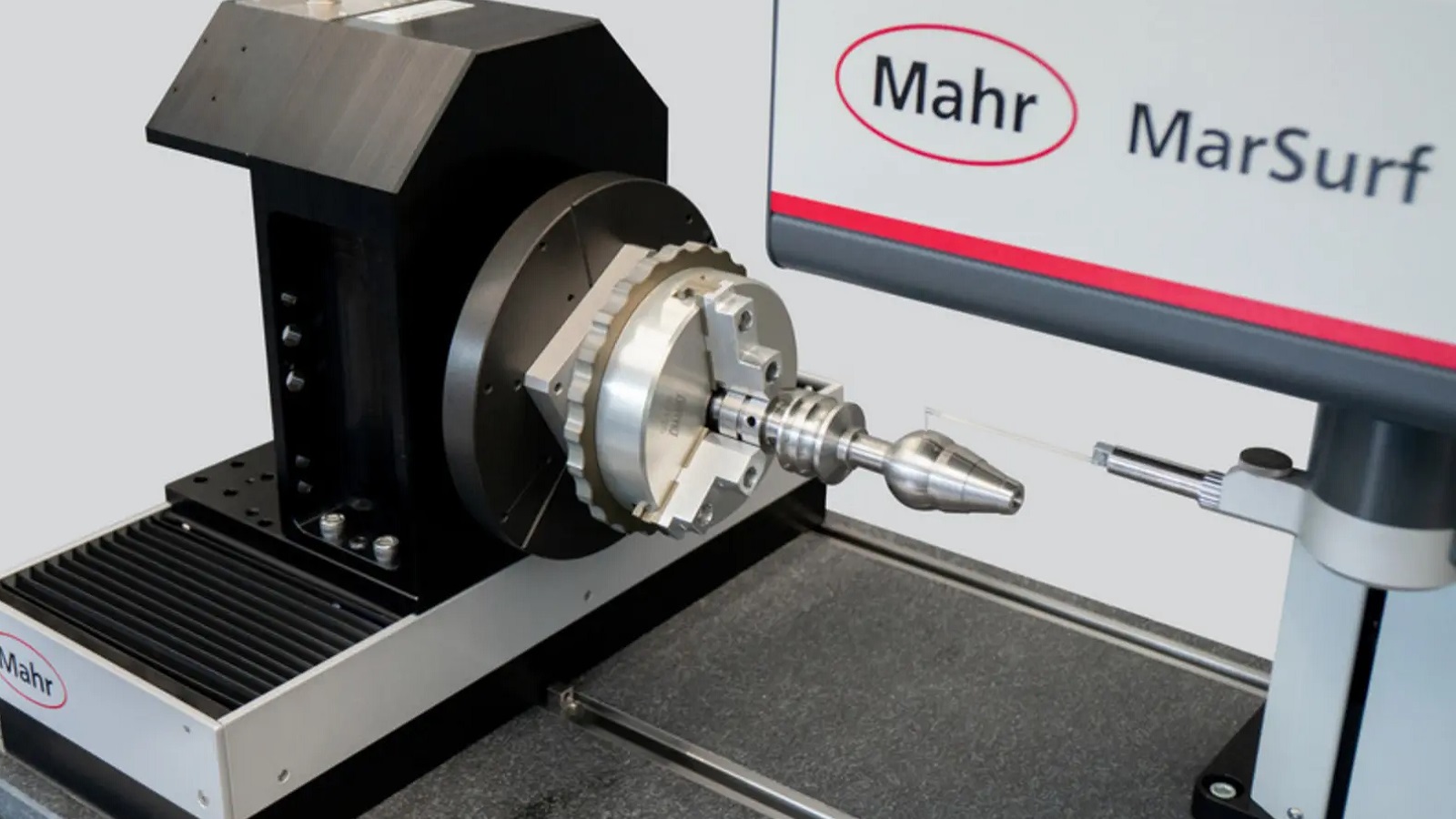

The system is intended for applications involving workpieces with multiple measurement locations, different spatial orientations and rotationally symmetric components that need to be measured at different angular positions.
Additional software modules support pallet measurements, allowing manufacturers to standardize recurring inspection procedures and increase the number of components that can be inspected within a given production cycle.
The modular Evo builds on the architecture of Mahr’s existing MarSurf CNC modular measuring stations. Positioning axes provide 200 mm of travel, while the system can be configured with different combinations of linear and rotary axes. Existing feed devices, accessories and workpiece holders can also be incorporated, providing continuity for users already working with the MarSurf platform.
A new 280 mm feed axis expands the measurement volume and provides additional flexibility for higher-volume applications.

Mahr is also offering the MarSurf CNC modular Evo as a fixed, factory-preconfigured measuring station. This is intended to simplify system selection and planning by providing a standardized configuration rather than requiring the individual assembly and coordination of system components.
Configurations are available with one linear axis; one linear and one rotary axis; or two linear axes combined with a rotary axis.
The MarControl control unit is provided as standard, supporting operation of the system in production environments.
