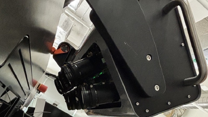

That is exactly the space being explored at the Commonwealth Center for Advanced Manufacturing (CCAM), Disputanta, VA, USA, where Research Engineer for Additive Manufacturing, Kamden Shephard, is a primary user of Additive Assurance’s AMiRIS in-situ monitoring system.

Shephard also highlighted the quality of AMiRIS spatial resolution, noting that the system’s multi-camera near-infrared approach provides exceptionally high-resolution process insight.
“With AMiRIS, you are getting spatial resolution that approaches the scale of individual scan tracks,” he says. “That level of detail has a lot of potential as powder bed fusion evolves toward more advanced process monitoring, beam control, and feedback control. The underlying resolution gives the system significant potential as the industry moves in that direction.”
