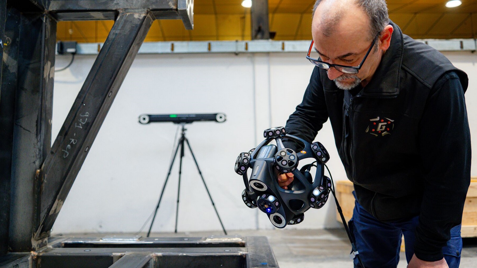

Virtual metrology means performing dimensional verification against a high-fidelity 3D digital representation of the part, rather than relying on the physical part alone. Captured through high-speed 3D scanning or computed tomography (CT), that representation decouples data capture from data analysis, so the record survives long after the physical part has shipped, been assembled, or been destroyed in testing.
In practice, that changes three things about how the resulting data gets used:
  • The measurement strategy becomes reusable, since registration methods, fitting algorithms, and new points of interest can all be added later without remeasuring the physical part
  • Access becomes shared across sites, since a captured part can be reviewed anywhere in minutes, letting a component made at a satellite plant be checked against group-wide standards before it leaves the shipping dock
  • Metrology data use becomes cross-departmental, since manufacturing engineers can check clamping surfaces and research and development (R&D) teams can study the same data for fatigue analysis, without a second measurement run
Taken together, this is sometimes described as a digital twin: an accurate, continuously updated 3D model of the component that complements the rest of the digital thread, rather than a separate system to maintain.
