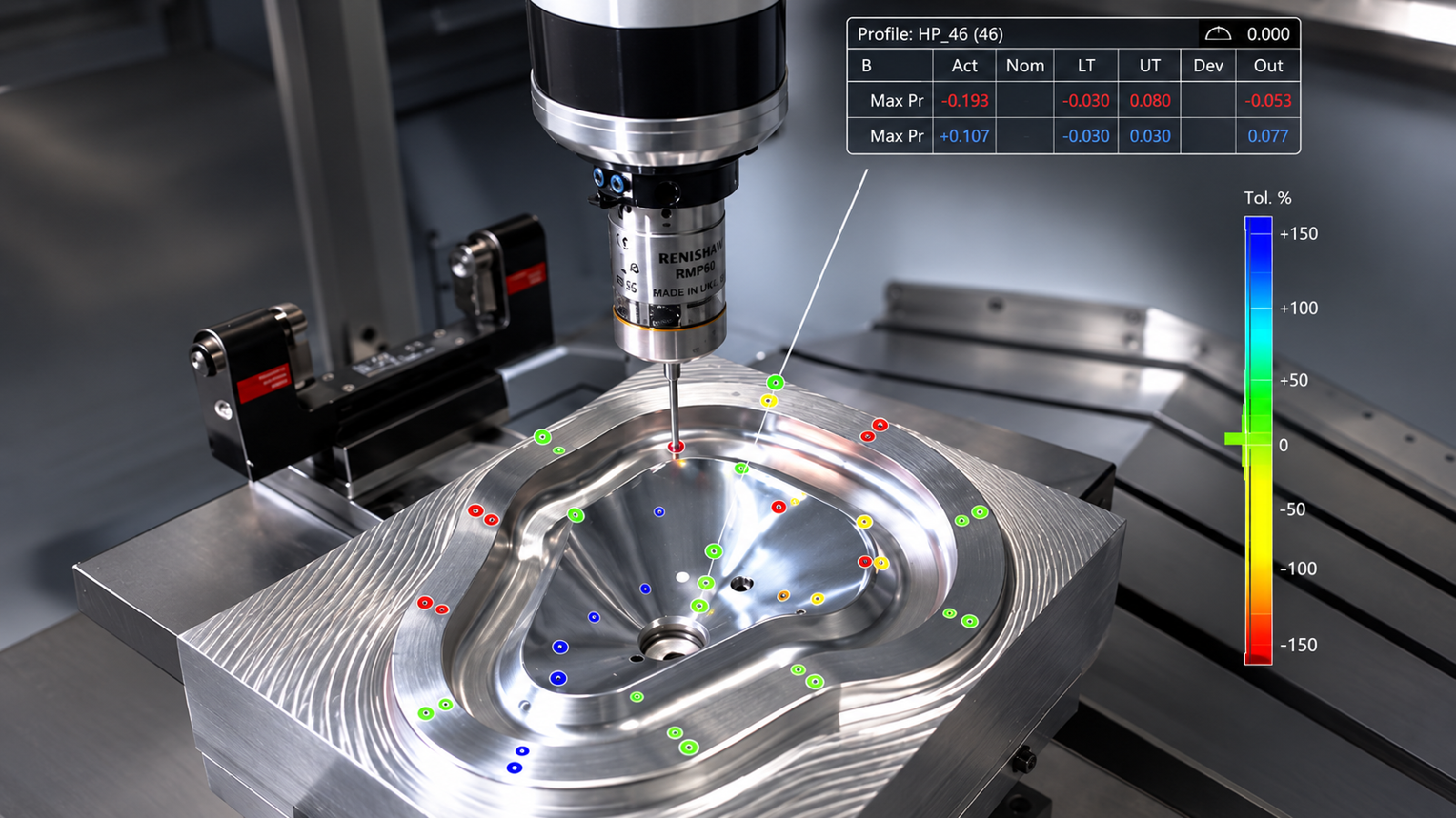

On-machine inspection addresses the problem by performing measurement directly on the CNC machine. AAT, a pioneer in on-machine measurement and closed-loop feedback, has been implementing this solution via CAPPS NC at a number of large manufacturing sites.
The operational sequence becomes:
Set up → Cut → Measure → Correct → Document
The component remains clamped while measurement takes place. A probe sensor measures the relevant features, the software calculates deviations and, where the process permits automated correction, appropriate tool offsets can be updated before machining continues.

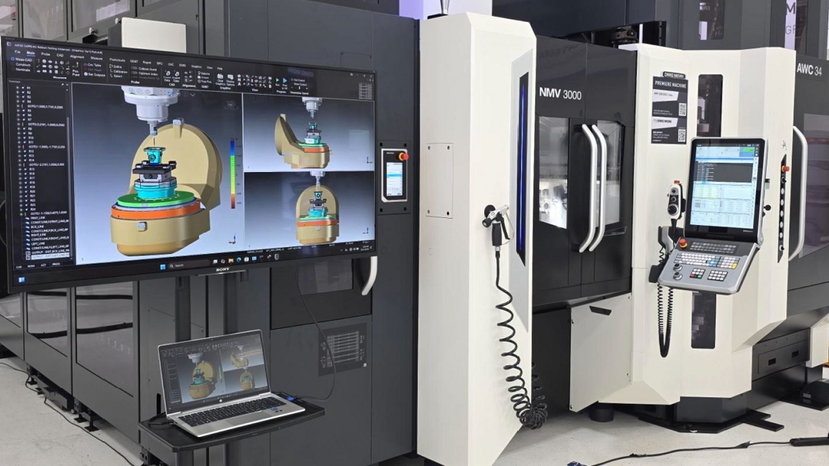

From CNC Machine to Virtual CMM
Modern on-machine inspection is also moving beyond basic probing macros. Advanced software can bring full dimensional measurement and GD&T capability onto the CNC machine, using measurement programming based on the same DMIS standard employed by standalone CMM systems.
This makes the CNC machine effectively a virtual CMM, capable of carrying out much more comprehensive inspection without requiring the component to leave the machining environment.
The measurement technology itself can also be selected according to the application. Touch probes can be used for discrete features, while scanning probes, laser line scanning sensors can address applications where different measurement characteristics are required.

Perhaps the most obvious benefit of closed-loop machining is the ability to identify dimensional drift before it produces significant quantities of scrap.
Consider a finishing operation in which a critical dimension gradually moves out of tolerance as a tool wears.
With conventional inspection, the problem may not be discovered until the component has completed the machining process. With an in-process measurement cycle, the feature can be measured between operations.
If the deviation is within the range that the process is designed to correct, the appropriate offset can be applied and machining can continue.
A mold-making application illustrates the principle particularly well. Rather than allowing an incorrectly sized feature to result in a rejected mold component, the machine can measure, calculate the deviation, make a correction and perform another finishing pass. An error therefore becomes another machining operation rather than a scrapped component.
Reported results from applications of this approach have included reductions of approximately 20% in scrap and rework.
