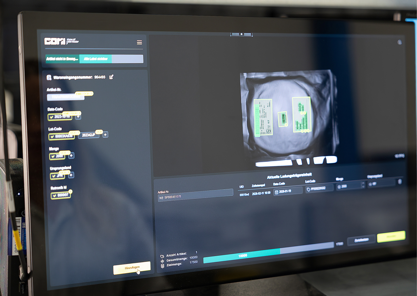

To achieve this, the system recognizes all labels on an object, reads printed text as well as 1D and 2D codes, and then interprets the content using artificial intelligence. Handwritten entries can also be processed if required. Crucially, recognition does not rely on predefined label standards. New layouts, languages or code formats can be handled without retraining – a key factor for scalability and long-term viability.

Following image acquisition, the AI analyses the data in several stages: Labels are localized, contents extracted and then semantically interpreted, for example to clearly assign part numbers, batches or manufacturer information. The results are transferred directly to connected ERP systems such as SAP or proALPHA, including real-time comparison and validation.
For users, this means a significant reduction in manual inspection steps and sources of error. At the same time, data quality improves and complete documentation of all item movements is created. The resulting 100 per cent traceability is increasingly becoming a decisive differentiator, particularly in view of stricter regulatory requirements in downstream industries such as medical technology.
