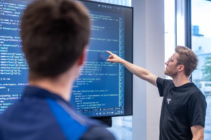

The starting point is further development of the software architecture. At its Landshut facility, the BMW Group relies on open platforms that enable the flexible and scalable training of robots by combining traditional (deterministic) programming with modern AI models (Vision-Language-Action (VLA) models), integrating visual information, language comprehension and robot actions. The goal is a modular robotics ecosystem in which diverse systems work together. This creates a technical basis for new functionality and a wide variety of industrial applications.
This requires reliable data. At Plant Landshut, the project team captures data from real production environments and test setups, and integrates it into robot simulations, in which movement patterns and motion planning are modelled virtually. This enables processes to be tested in advance and learning processes to be accelerated. New approaches are initially trialled outside of ongoing production, implemented in pilot projects and then scaled up in stages.

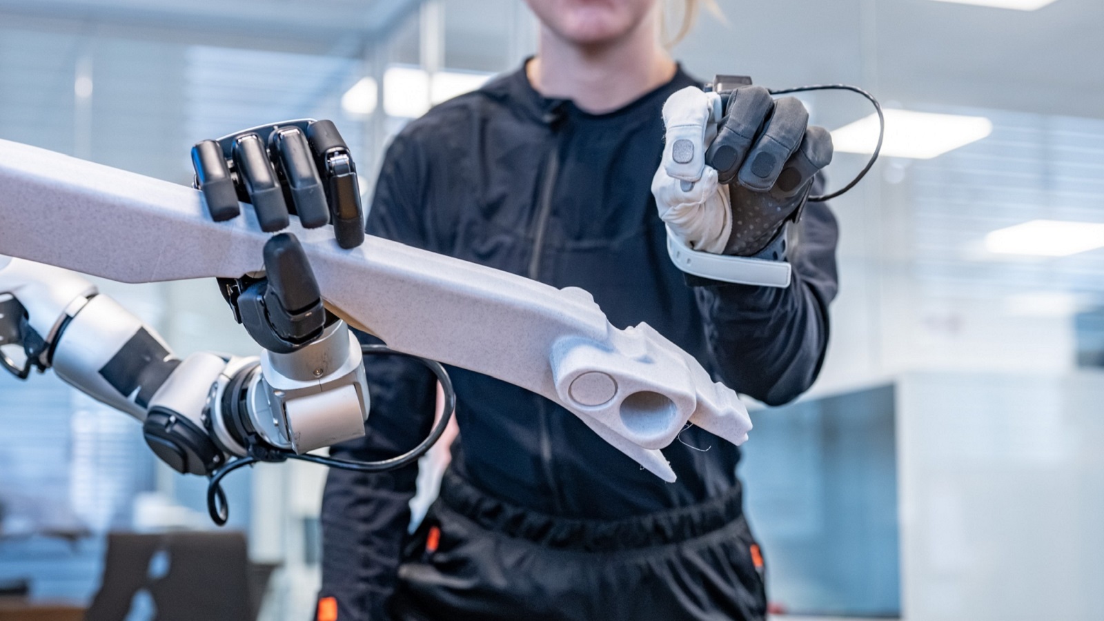

In parallel, humanoid robotic systems acquire new skill sets through demonstration-based learning. In this process, movement patterns and work sequences are first demonstrated by the project team. The data generated in this way is collected by camera systems, motion capture suits and data gloves. It is then converted into generalisable behavioural models โ€“ known as policies โ€“ that can be applied to different tasks and use cases.
