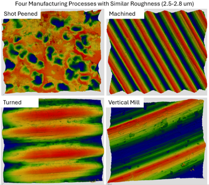

Figure 2. Same Ra, Different Surface Function. Two surfaces can have identical Ra values while exhibiting very different topographies and performance characteristics. This illustrates why a single 2D profile average may not fully represent sealing behavior, wear behavior, or lubricant retention across the full surface area.

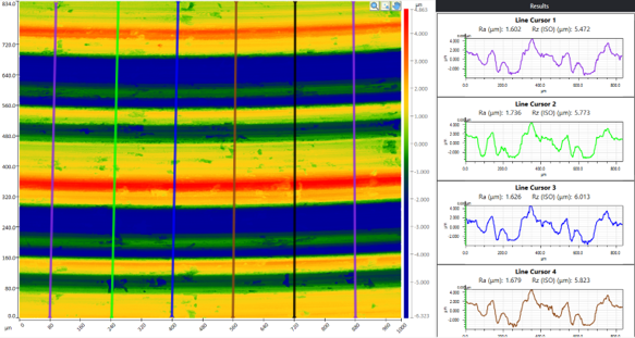

To illustrate this, consider a surface with a milled finish. If this surface is measured using traces in the Y (vertical) direction, the variations caused by the horizontal milling pattern will be captured in every trace. In this case, the optically measured Sa and the Y-direction stylus Ra may appear very similar.

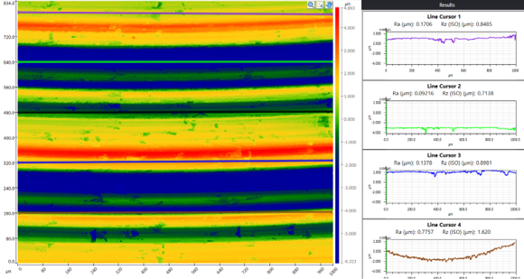

However, if the traces are instead collected in the X (horizontal) direction, parallel to the milling pattern, the measured height variations along each trace will be minimal. This effectively ignores the dominant surface structure, resulting in a X-direction Ra value that differs significantly from the true 3D Sa measurement. In this case, the resulting average is not representative of the actual surface variation.
Figure 3. Directional dependence of roughness measurements on a textured surface. Top: Ra values obtained from profiles measured in the Y-direction vary only slightly, from 1.60 to 1.74 µm. Bottom: Ra values obtained from profiles measured in the X-direction vary substantially, from 0.09 to 0.78 µm. The large difference between measurement directions illustrates the limitations of single-profile roughness measurements on anisotropic surfaces and underscores the value of areal surface characterization.
Importantly, this issue is not limited to highly directional surfaces. Even surfaces with more random or isotropic textures can exhibit variability in Ra depending on trace location and orientation. The following examples demonstrate how surfaces that appear similar in all directions can still produce inconsistent results when measured using stylus-based methods

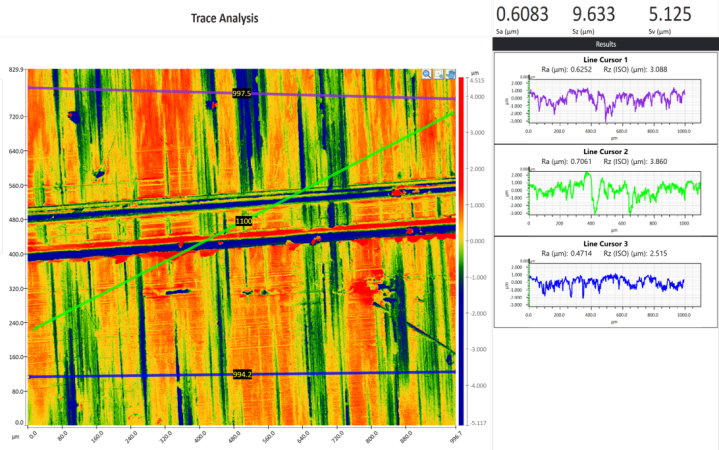

Figure 4. Ra variability from 0.47 to 0.71 µm dependent on where a trace is made, whereas the Sa value of 0.608 µm is constant across the entire surface.
