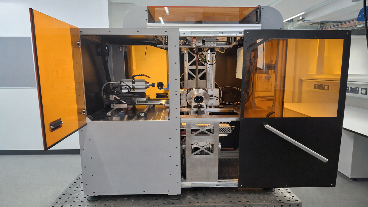

XYZO has formally launched its automated hybrid manufacturing technology, introducing a new approach to digital production of polymer parts that brings additive manufacturing (AM), precision machining, finishing, inspection, and process control together within one connected platform.
Developed following extensive research into the barriers preventing AM from progressing from prototyping into repeatable production, the XYZO platform is not an experimental concept or research demonstrator. It is a commercially focused manufacturing technology designed to address one of AM’s most persistent limitations, namely printing the part is often only one stage of making the finished component.
Automated Hybrid Manufacturing Platform
Rather than positioning AM as the complete production solution, XYZO uses it as the driver within an automated hybrid manufacturing line.
The modular platform can integrate processes including Digital Light Processing (DLP), Fused Deposition Modelling (FDM), pellet extrusion, drop-on-demand deposition, and CNC micro-milling, alongside cleaning, curing, inspection and other post-processing operations.
The objective is simple, move from a digital design towards a finished, measured component through a controlled workflow while dramatically reducing manual intervention between individual manufacturing stages.

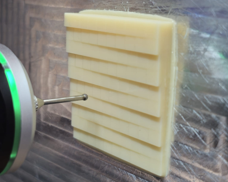

In-Process Part Inspection Verifies As-Built Geometry
The system uses a touch-trigger probe accessed via the CNC machinining automatic tool changer. Additive-then-finish workflows only make sense if the printed part matches its CAD file closely enough for the finishing step to be valid – an assumption every additive process violates to some degree (resin shrinkage and light bleed-through in DLP, warping in FDM, distortion in powder-bed fusion). In-process inspection closes that gap by measuring the as-built geometry before programming the finishing pass, so machining targets reality instead of intent.
