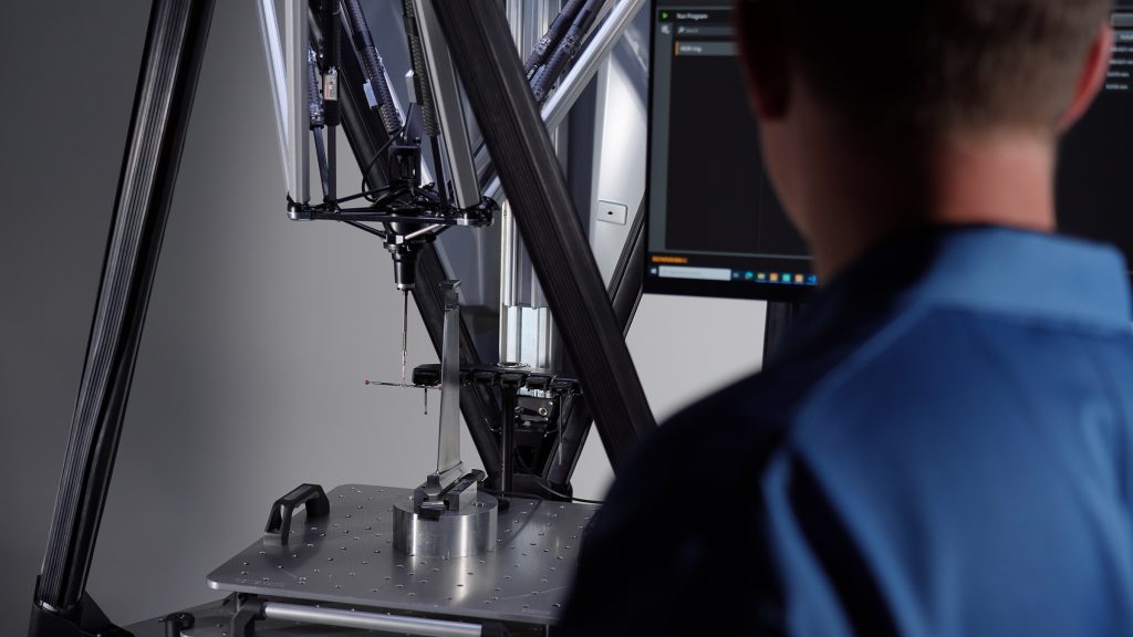

The company said growth in Industrial Metrology was driven primarily by its emerging metrology systems and software products, while sales of traditional metrology sensors were broadly flat. Renishaw continues to expand beyond individual measurement sensors into higher-value systems and software. The company highlighted the market response to its Equator-X gauging system, as well as the introduction of MODUS IM Equator software, which is designed to improve the productivity and functionality of Equator and Equator-X systems.
