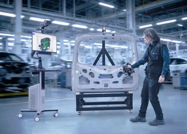

The newly launched FreeScan Combo+ Wireless brings cable-free mobility to the popular combo family.
Next-Gen Connectivity & Power: Driven by the Wi-Fi 7 protocol, the system delivers fast, stable wireless data transmission across complex factory floors and outdoor environments, supported by a high-capacity rechargeable battery providing up to 2 hours of continuous scanning.
Built-In Photogrammetry: Incorporating SHINING 3D’s patent Video Photogrammetry (VPG) Technology, operators can capture large-scale frameworks using scale bars to maintain optimized volumetric accuracy before transitioning to laser scanning.
Enhanced Scanning Performance: In High-Speed Scan Mode, the system now features 93 laser lines, complemented by 25 parallel laser lines in Detailed Scan Mode, achieving frame rates up to 180 FPS.

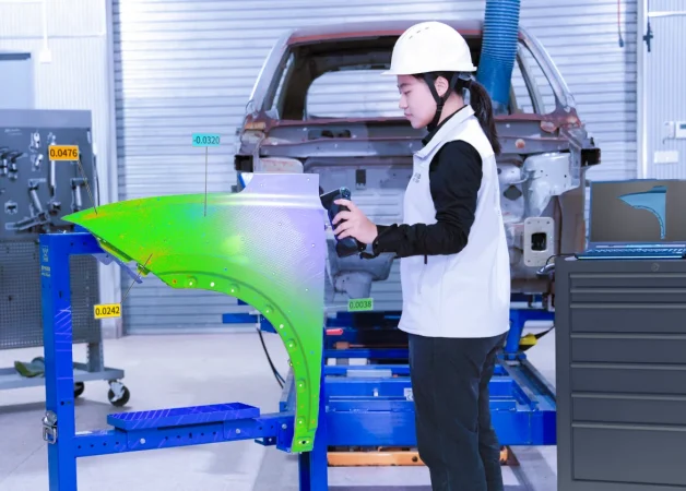

Intelligent Workflows: Scanning software introduces an AI Recognition function that automatically detects holes during scanning, allowing users to switch seamlessly into inspection software for 3D color map comparisons, GD&T analysis, and sheet metal inspection.

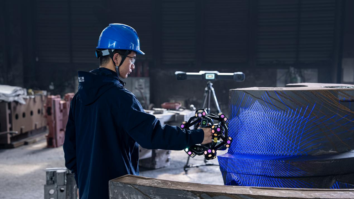

Designed for efficient large-scale workpiece measurement, the FreeScan Trak ProW+ is the upgraded successor to the FreeScan Trak ProW.
Expanded Single-Station Volume: Features an ultra-long tracking distance of up to 8.6 meters and expands the single-station tracking volume to 156 m³, minimizing the need for leapfrog operations.
High-Speed Marker-Free Scanning: Delivers speeds up to 7.6 million points per second with multiple laser modes (93 crossed lines, 25 parallel lines, and a single line) without requiring time-consuming marker placements.
Flexible Probing & Multi-Tracker Support: Can be paired with the FreeProbe series for wireless portable probing on hard-to-reach features, and multiple Trak ProW+ systems can work together for full-field coverage on extremely large objects.
