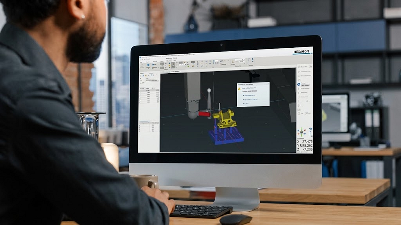

Wenzel WM | Quartis R2026-2 Enhances Measurement Evaluation, Reporting and Digital Integration
WENZEL has released WM | Quartis R2026-2, the latest version of its measurement software, introducing a range of enhancements designed to improve efficiency, measurement reliability and standards compliance across industrial metrology workflows.
The update addresses multiple stages of the measurement process, from data acquisition and feature evaluation through to reporting and the integration of measurement results into wider digital quality processes.
