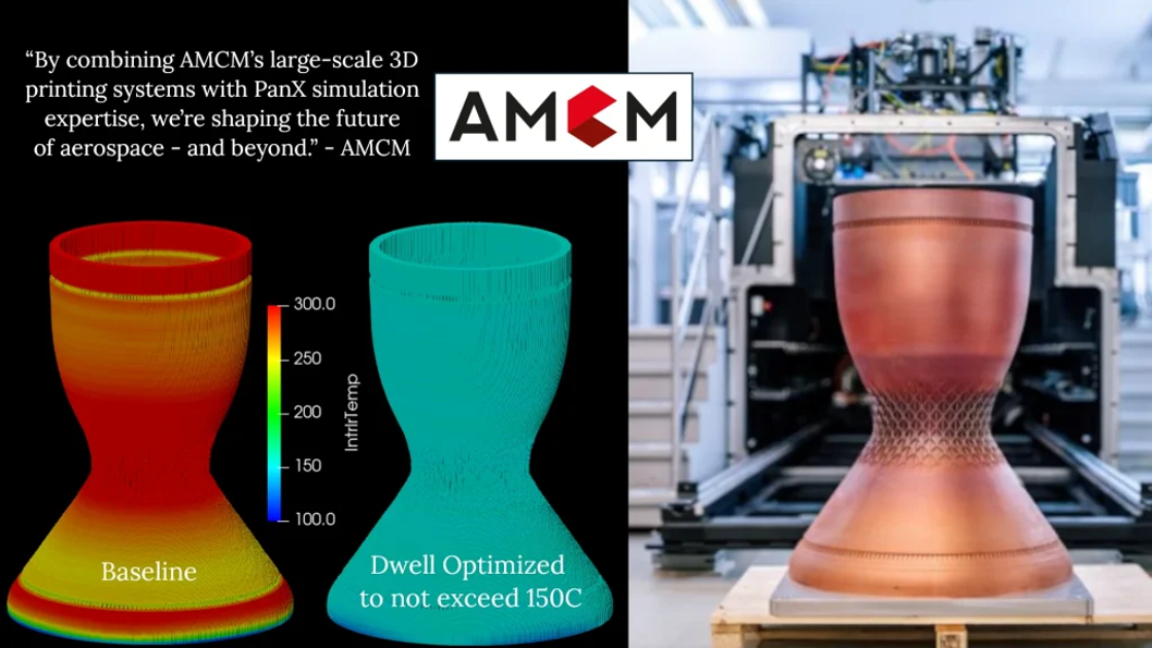

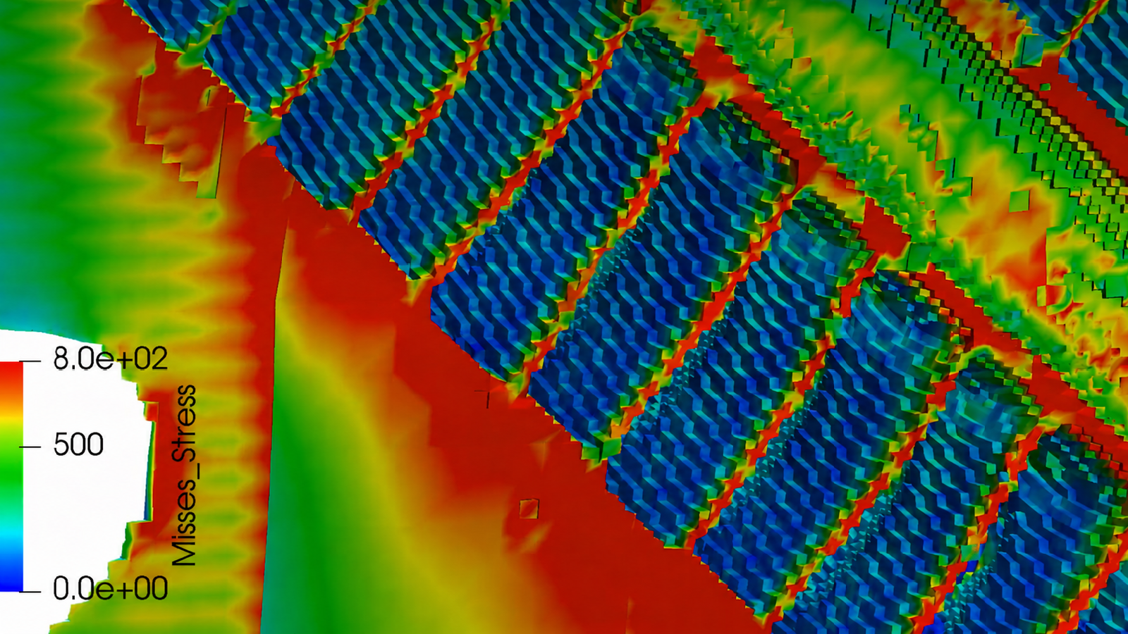

Today’s critical parts look very different. Part size and complexity have dramatically increased. Rocket hardware, dense heat exchangers, large structural components, and part-scale DED repairs push old simulation tools well past their computational limits. Mesh counts explode. Run times balloon. The solver simply fails, and teams fall back (explicitly or quietly) to trial-and-error.

PanX is an enabling technology designed specifically to solve the problems of modern AM. In practice, it is often the only production-ready solver that can handle these complex parts at the required model resolution and accuracy, and where older solvers can run, PanX typically runs 10–100× faster with superior accuracy.
PanX enables simulation and optimization of even the most complex parts. This AMCM M 8k component has dimensions of 820mm x 820mm x 1,200mm (image courtesy of AMCM)

A solver that only produces stress and distortion plots is misaligned with the decisions that actually govern flight readiness, warranty exposure, and program economics. PanX was built explicitly with those qualification-grade and business-critical questions in mind, not as a prettier way to look at the same old contours, but as infrastructure for how metal AM gets designed, qualified and run in production.

PanX Feed-forward power optimization achieves uniform melt quality by varying laser power spatially across each layer based on the predicted interalyer temperatures.
