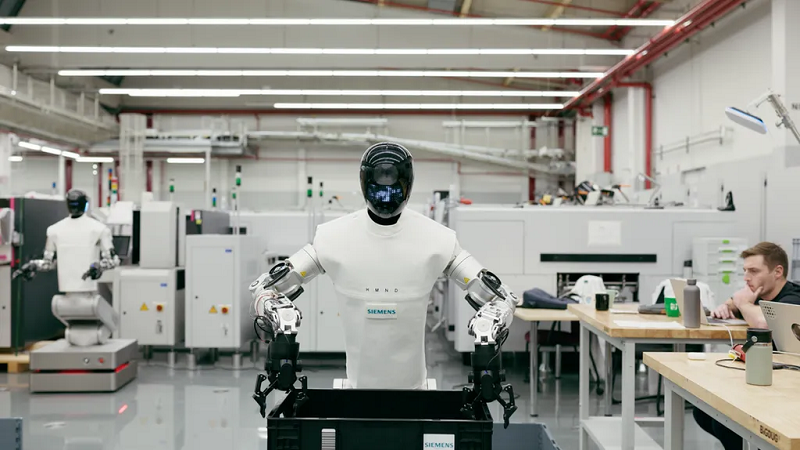

Siemens and Humanoid have announced a landmark milestone in the journey to bring physical AI from vision to industrial reality. Humanoid’s HMND 01 wheeled Alpha humanoid robot, built using the NVIDIA physical AI stack, has been successfully tested in operations at Siemens’ electronics factory in Erlangen, Germany, performing autonomous logistics tasks. This builds on the Siemens and NVIDIA strategic partnership, announced at CES, to build the world’s first fully AI-driven, adaptive manufacturing sites.

The HMND 01 Alpha robot was deployed in Siemens’ logistics operations, where it autonomously executed tote-handling tasks – picking, transporting and placing containers for human operators. All target performance metrics were met, including a throughput of 60 tote moves per hour, uptime exceeding 8 hours, and autonomous pick-and-place success rates above 90 percent.
