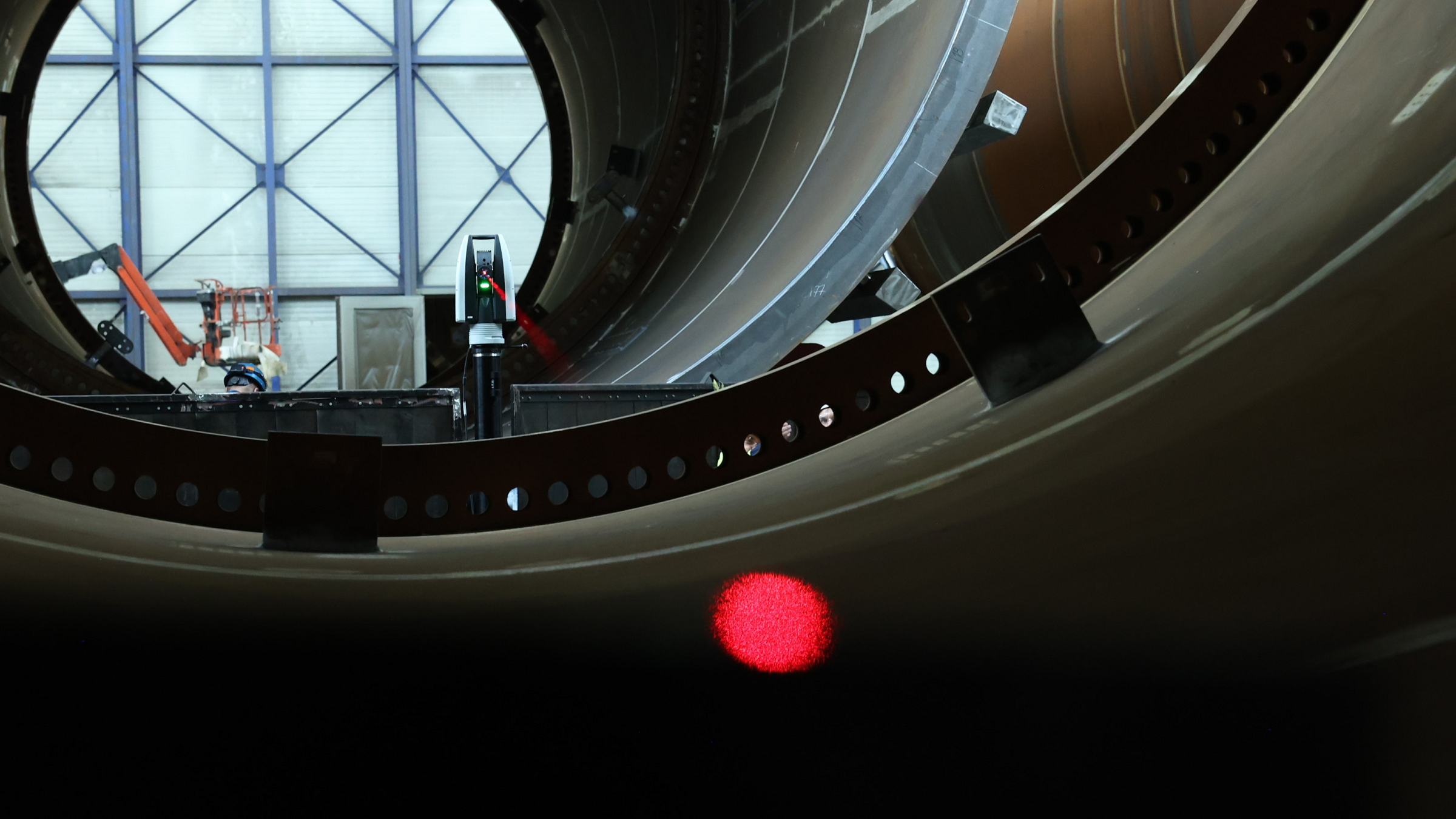

Hexagon is working with the manufacturing community to change this, building on a trusted legacy of innovation in laser tracker technology. Its Leica Absolute Tracker ATS800, launched in 2025, introduced a new category of measurement technology – high resolution direct scanning from up to 40m away – and today the ecosystem has responded to drive further innovation in the device and its applications.

The ATS800 is a light, portable battery-powered measurement device that can be transported in a case and mounted onto a tripod or rack by a single person for use in multiple locations onsite with 6 hours to 12 hours (with 2 batteries) operating time between charges.  From a single vantage point, its zooming lens assembly and panoramic view finder allow it to assess features and surfaces within large structures at high resolution.

The tracker’s built-in Wi-Fi enables remote operation, meaning users can perform safer measurements even in hazardous or hard-to-reach areas. It also enables highly automated processes using autonomous mobile robots (AMRs). Using FeatureDetect and PowerLock, the ATS800 can quickly identify and ‘lock on’ to a sphere target in a new area to establish its position in a coordinate system and begin measurement unattended.
