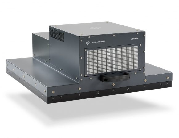

Rohde & Schwarz has introduced the R&S IMAGER, a real-time millimeter wave inspection system designed to enable non-destructive quality inspection of packaged products across pharmaceutical, logistics and manufacturing applications.
Using non-ionizing millimeter wave technology, the system can inspect products through common packaging materials without the use of X-rays, providing manufacturers with a safe method of verifying product integrity while protecting both operators and sensitive products. The technology generates high-contrast three-dimensional images that can be incorporated into AI-driven inspection systems for automated defect detection and quality assurance.
High-Speed Volumetric Inspection
The R&S IMAGER expands Rohde & Schwarz’s industrial inspection portfolio by combining millimeter wave imaging with advanced signal processing. The system transmits millimeter waves through packaging materials, analyses the reflected signals using a sensor array and reconstructs detailed volumetric images capable of revealing hidden components, assembly errors and material defects.
Unlike conventional vision systems, which are limited to surface inspection, the R&S IMAGER provides a three-dimensional digital representation of every inspected package, enabling manufacturers to verify internal product configuration at production-line speeds.

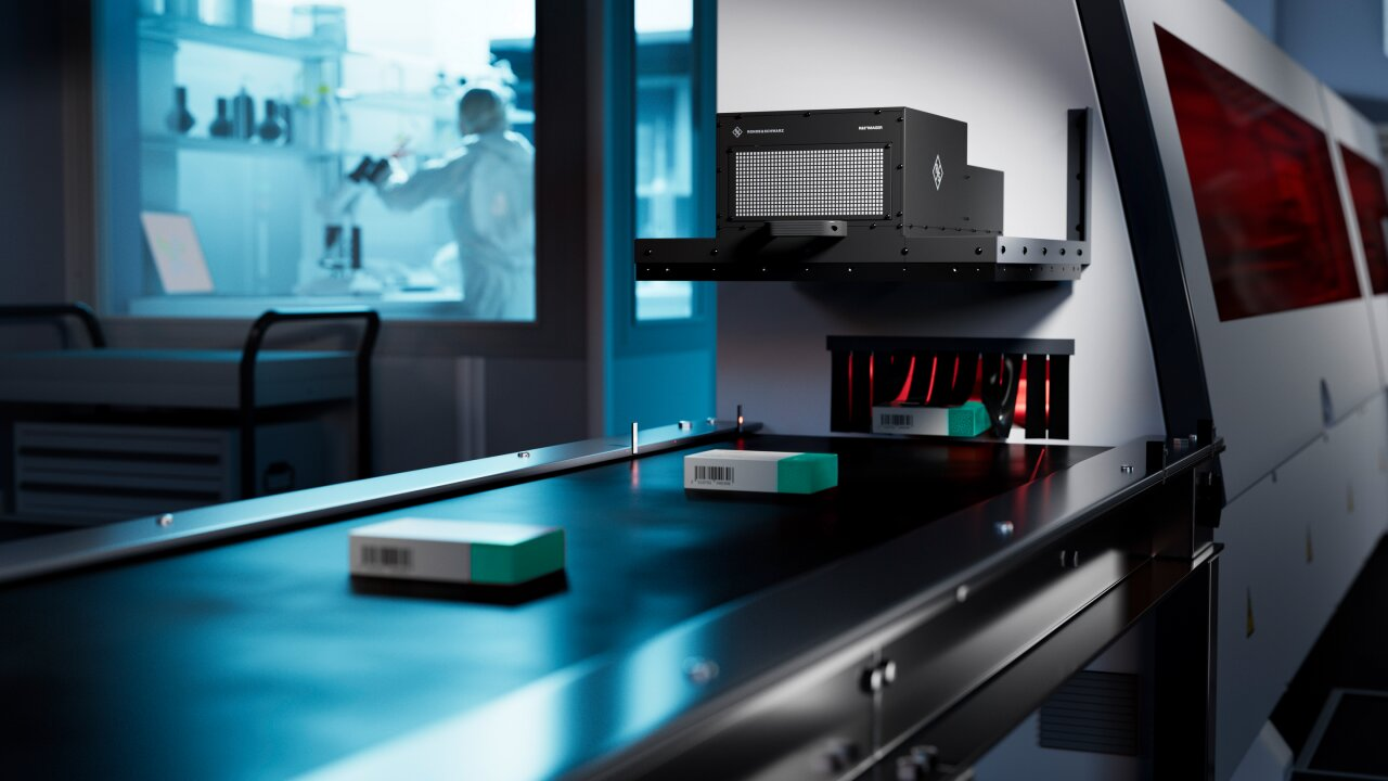

Installed over conveyor systems, the R&S IMAGER continuously captures volumetric images of packaged goods, allowing AI algorithms to detect missing components, misplaced items or concealed damage in real time. The technology can improve inventory accuracy, reduce manual inspection and provide comprehensive digital records throughout the supply chain.

Designed for straightforward integration into existing production environments, the R&S IMAGER interfaces with production control and quality management software, allowing manufacturers to expand inspection capability without major modifications to existing production lines.
