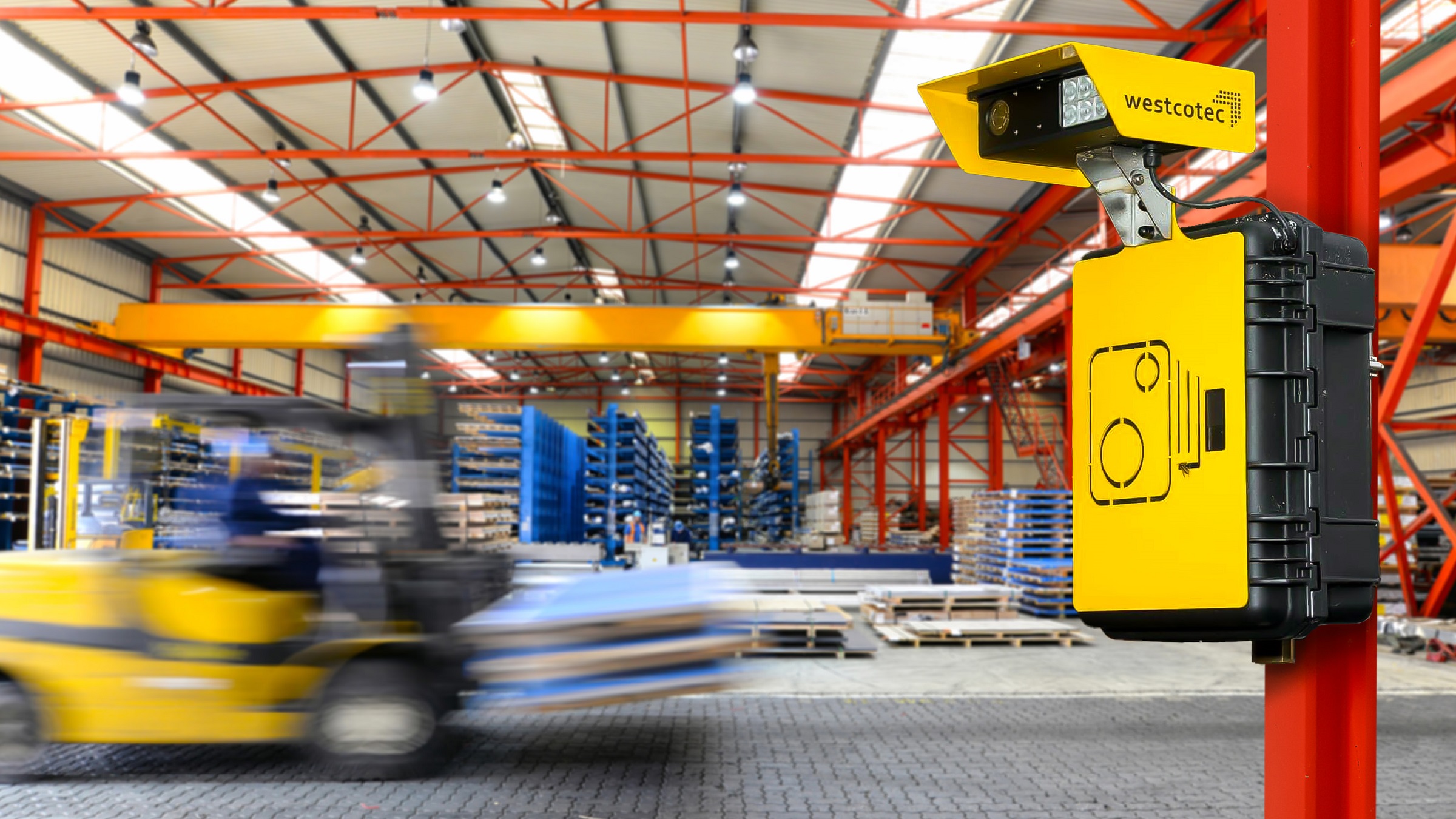

Combining radar, ANPR and industrial imaging, the system captures speed and vehicle data to support safer operations across sensitive environments.
“We repeatedly see that internal safety rules are not enough to prevent dangerous driving. Intelligent systems are needed that not only record data but actively contribute to changing behaviour,” explains Olly Samways, Sales Director at Westcotec. The Automatic Speed Watch Camera detects vehicles exceeding a defined speed limit and captures a high-resolution image. In addition to the licence plate, speed, date and time are recorded; Driver and Vehicle Licensing Agency (DVLA) integration provides further details such as make, model, and colour. Processing is radar-assisted and uses ANPR matching to reliably identify vehicle data.
The information is then structured, making it easy to interpret, export, and use for analysis. Repeating offences can also be detected and serve as the basis for targeted measures to improve driving behaviour. Data can be accessed via Wi-Fi or USB, managed remotely through the Westconnect platform, or automatically delivered by email. Secure Digital (SD) card recording eliminates the need for a laptop to always remain connected.
