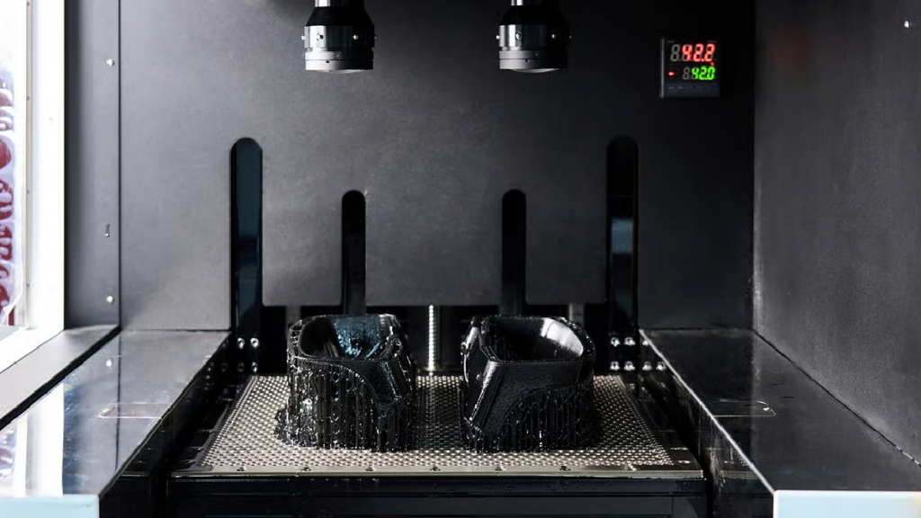

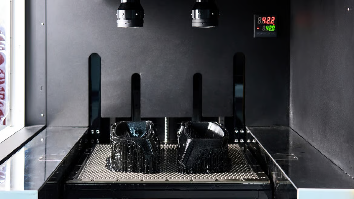

For polymer applications, the center employs Vat Photopolymerization technologies, including Digital Light Processing (DLP), which uses ultraviolet light to cure entire layers of resin simultaneously, and Stereolithography Apparatus (SLA), which traces intricate geometries with precision-guided lasers. These technologies are particularly well suited for highly detailed components used in design validation, prototype development and other applications requiring fine dimensional accuracy.
The center also operates Polymer Powder Bed Fusion (Polymer PBF) systems, which fuse powdered polymer materials layer by layer without requiring support structures. This minimizes material waste and post-processing requirements. After vapor-smoothing treatment, components can achieve surface finishes comparable to injection-molded parts, making the technology suitable for high-quality customized and development components.

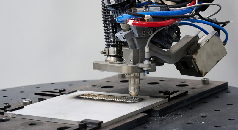

The AMSC also utilizes Directed Energy Deposition (DED) technologies for larger-scale metal components. One example is DED-Wire Arc Additive Manufacturing (DED-WAAM), which uses welding-arc technology to deposit metal layer by layer. Compatible with materials including steel, stainless steel, aluminum and titanium, the process is particularly effective for producing large structural components that would be difficult to manufacture as a single piece using conventional methods.

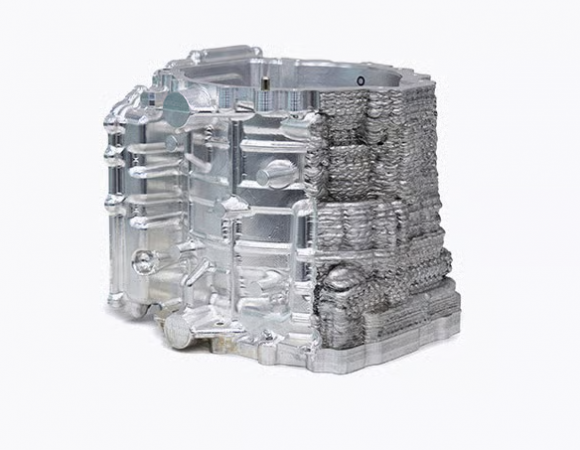

The technology is also supporting Hyundai Motor’s motorsports activities. Components such as anti-roll bar blades, damper brackets and brake duct rails are being produced using additive manufacturing to achieve the combination of lightweight construction and structural rigidity required in racing environments. The center also showcased a vehicle motor housing featuring both its as-printed DED-WAAM structure and its post-processed computer numerical control (CNC)-machined finish, demonstrating how complex metal components can be produced and refined through additive manufacturing workflows.
