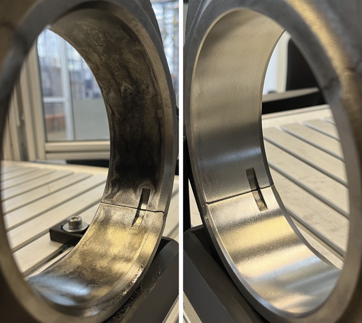

The robotic cleaning solution was developed and validated in the Use-Case Lab at Fraunhofer IFF. One particular challenge was to automate the cleaning of large, precision connecting rod components, while complying with strict quality standards. The robotic system uses the same tool used in the manual process. It is now used precisely and reproducibly through robotic guidance. Controlled nondestructive machining is additionally intended to maximize the number of times the parts can be reused.

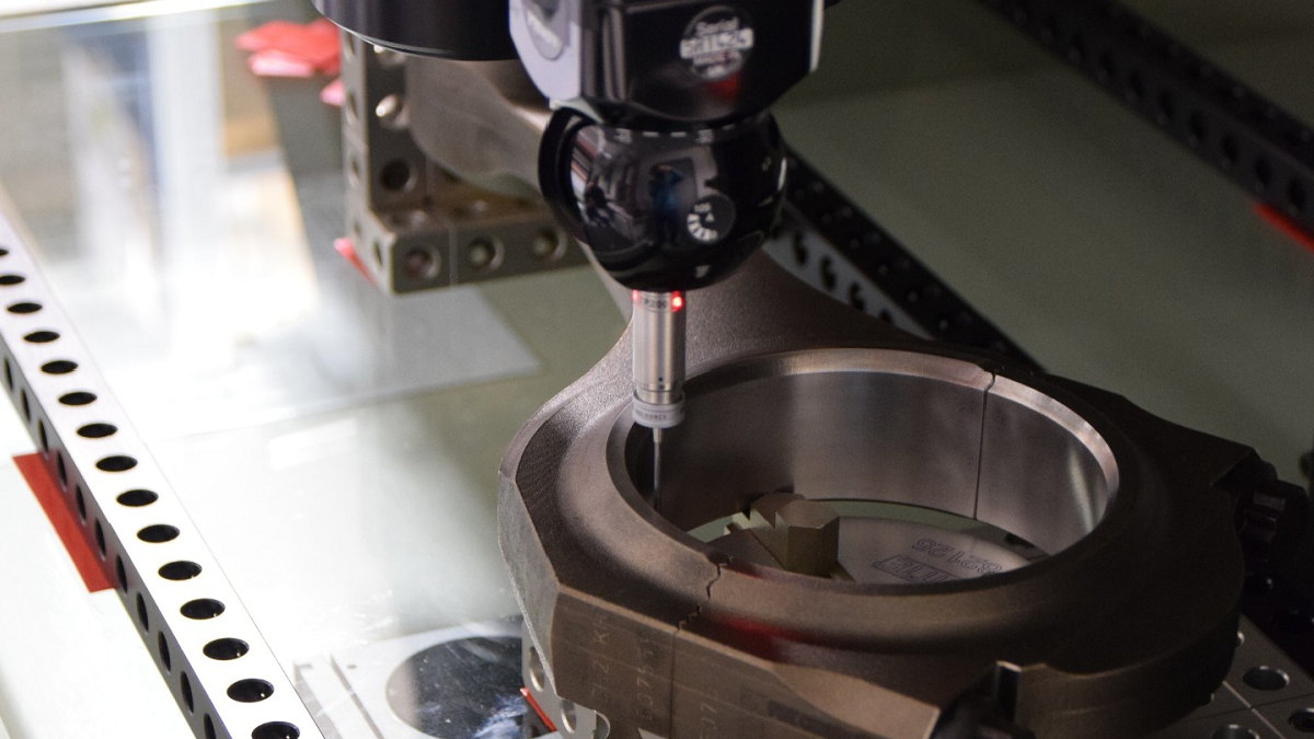

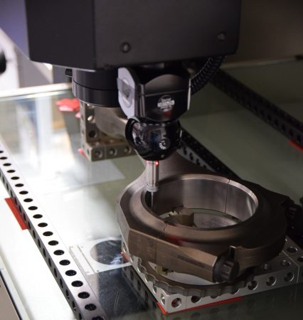

Fraunhofer IFF has the infrastructure needed for this in its Use-Case Lab. Industrial robotics, force/torque sensors and 3D touch probe scanners were used in the project. An experienced interdisciplinary team built and tested a functional proof-of-concept with a number of component options. The automated process achieved excellent cleaning results with high reproducibility, precisely controlled contact forces and minimal machining. This makes it possible to reuse connecting rods numerous times.
