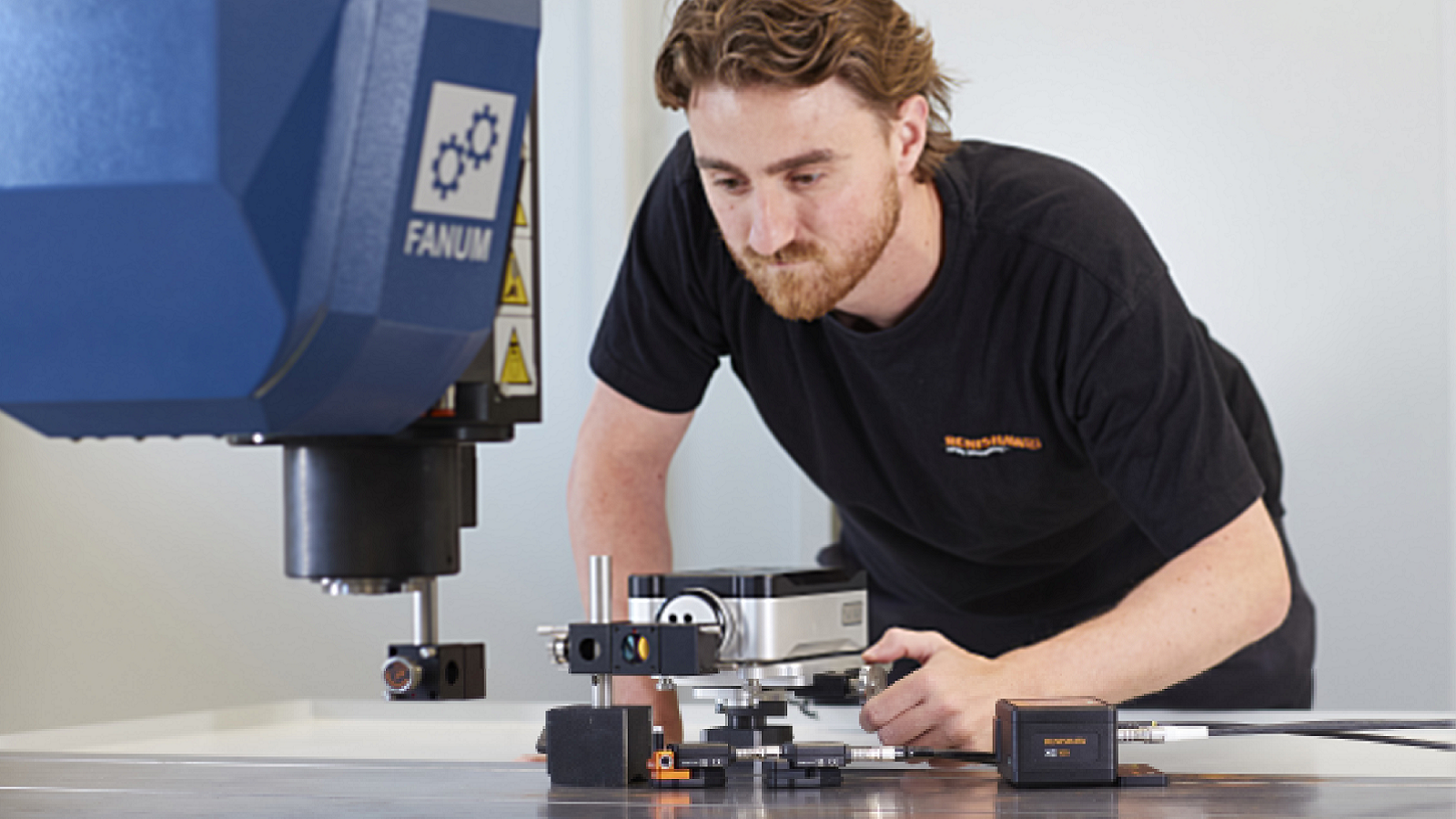

The XC100 compensator measures air temperature, air pressure, and relative humidity, then automatically adjusts the measured laser wavelength. It also measures material temperature, enabling calibration results from machines operating at different temperatures to be normalised to a standard temperature. Compatible with the XL-80 laser interferometer, XM-60 and XM-600 multi-axis calibrators, and CARTO software, it provides a seamless experience across Renishaw’s calibration product range.

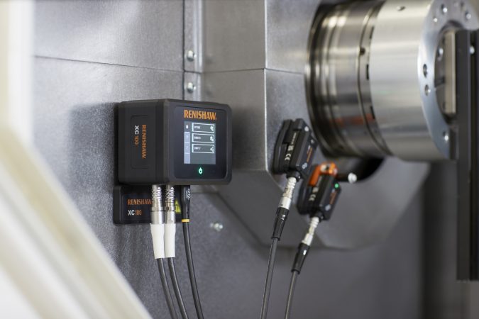

XC100 environmental compensator hub with air and material sensors set up in machine
Designed for maximum flexibility, the XC100 compensator supports any combination of air and material sensors, enabling comprehensive measurement of environmental conditions throughout the machine volume. The high-resolution LCD touchscreen display, flexible sensor configuration and versatile mounting features help users adapt the system for a range of calibration applications.
