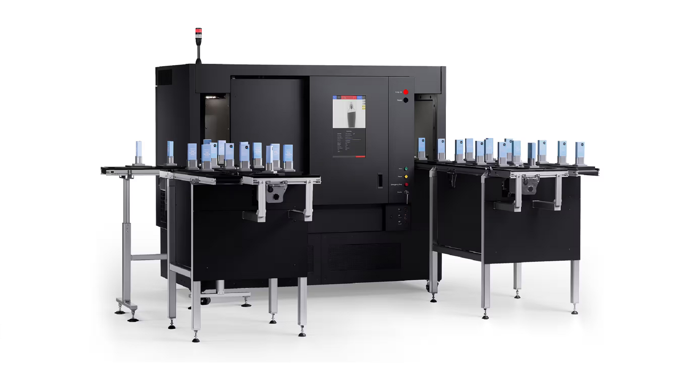

Triton Performance brings automated, non-destructive CT inspection to the factory floor, enabling manufacturers to scan parts at production speed and scale. In as little as 10 seconds per part, the platform provides complete volumetric CT reconstructions. Triton Performance can be used across a range of quality and process control applications to:
  • Catch internal defects before they escape and build a traceable inspection record without the need for specialized staff or dedicated facilities.
  • Create automated inspection recipes that target specific, known failure modes.
  • Identify and flag parts that deviate from expected norms and automatically group for review.
A measurement template built on Neptune Performance in the R&D lab becomes the automated inspection template for Triton Performance on the factory floor. Both platforms connect into Lumafield’s cloud-based Voyager software environment, establishing a unified quality thread across an organization. The critical tolerances, GD&T studies, and potential failure modes identified during development travel directly with the product into volume manufacturing to provide a single, global view of product quality across multiple facilities.
