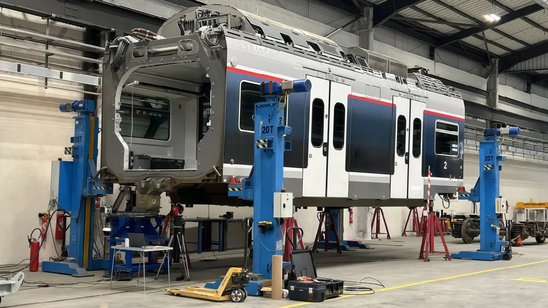

Laser Tracker Technology Delivers a Digital Alternative
To address these challenges, rail maintenance facilities are increasingly adopting laser tracker technology. The API Radian laser tracker provides a high-precision, large-volume measurement solution capable of performing comprehensive three-dimensional inspections of shock absorber mounts and other rail vehicle components.
The system delivers micron-level measurement accuracy, enabling reliable verification of critical form and positional tolerances. With a measurement radius of up to 80 meters, a single setup can cover an entire bogie assembly and, in many cases, significant portions of a rail vehicle without the need for repositioning. Data can be collected at rates of up to 1,000 points per second, dramatically reducing inspection times while increasing measurement confidence.
When paired with the API vProbe wireless probing system, the laser tracker can also access hidden or difficult-to-reach measurement locations. Probe extensions ranging from 50 mm to 500 mm allow operators to inspect deep mounting holes and recessed features that would otherwise be challenging to measure accurately. The portability of the system further enhances its suitability for rail maintenance environments, where measurement equipment often needs to be moved between workshops and inspection stations.
During an inspection, the laser tracker continuously tracks a retroreflective target or probing accessory as the operator measures key features. Three-dimensional coordinate data is transmitted in real time to measurement software, where geometric features such as planes, cylinders, and reference axes are created and compared directly with CAD models. The resulting deviation analysis provides a clear picture of component condition and supports repair or adjustment decisions.
