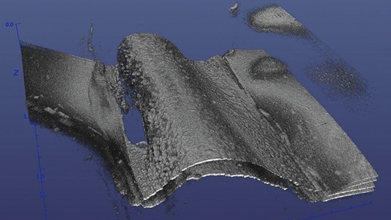

The system works by sending near-infrared light into the material and detecting the reflected signals. This data produces high-resolution three-dimensional images of the internal structure. Material defects, air pockets or inadequately sealed areas are rendered visible without damaging the packaging or the product.
Continuously Detecting Defects as Small as 8 Microns

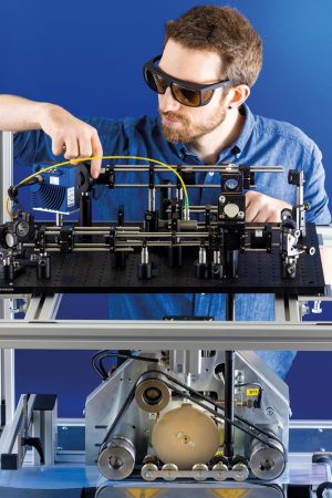

Fraunhofer IKTS’s innovative OCT-based testing system enables high-resolution, real-time, non-destructive detection of seal defects – even during the packaging process.
In the publicly funded OCTInline project, the IKTS researchers integrated the OCT technology directly in the sealing process in the packaging machine of an industrial partner. The system continuously and non-destructively tests the quality of the packaging seal in real time as the process is running at production rates of up to 25 meters per minute. “We can detect and visualize various pores in the seal down to a size of eight micrometers,” says Ralf Schallert, Characterization Technologies Group Manager at Fraunhofer IKTS.
The actual challenge lies in combining this high resolution with a high production rate. The smaller the defects are, the more data has to be collected and analyzed. Integrating the system into the industrial process also posed challenges for the project team. Even the slightest vibration of the film can affect the measurement. “We had to achieve a balance between depth of field, exposure time and film movement,” says Phillips.
