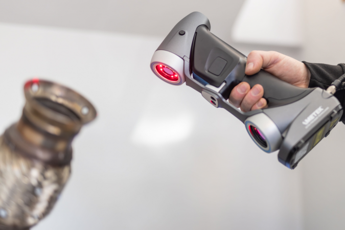

To further enhance its engineering capabilities and maintain the exceptionally high standards demanded by its customers, Primary Designs invested in the Creaform HandySCAN 307, supplied by Measurement Solutions Limited (MSL).
Since bringing portable 3D scanning in-house, the company has transformed the way it captures measurement data, develops new products and validates finished components, while bringing the measurement process in-house, creating new opportunities across the business and enhancing the way it develops, manufactures and validates high-performance exhaust systems.

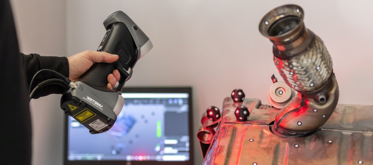

One of its primary uses is the development of bespoke exhaust systems for heritage vehicles and specialist automotive projects. Many of these vehicles are too rare or valuable to leave the customer’s premises, making traditional development methods both time-consuming and impractical. With portable 3D scanning, Primary Designs can visit the customer, capture a complete digital model of the vehicle and return to the workshop to complete the remaining design work in CAD. This significantly reduces development time while ensuring accurate measurement data is available throughout the project.
The scanner also plays an essential role in reverse engineering. Where original CAD models are unavailable, Primary Designs can scan existing exhaust systems to create accurate reference geometry for replacement or upgraded components.
Wherever possible, however, the team prefers to scan the entire vehicle rather than the original exhaust, recognising that original components may have distorted over time and no longer accurately represent the vehicle.

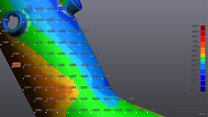

Within the company’s Formula One programmes, portable 3D scanning has become an integral part of quality assurance. Every race-ready component is inspected against its CAD model using VXinspect, generating detailed surface deviation reports that verify dimensional accuracy before components are supplied to the customer.

Instead of sending multiple engineers to develop the first prototype directly on a customer’s vehicle, a single engineer can now capture all of the required geometry during a one-day site visit before completing the remainder of the development digitally in CAD. This has significantly reduced development time while allowing skilled fabricators to remain focused on manufacturing.
As John Salisbury explains: “One of the last projects we completed before 3D scanning was introduced required three of our highly skilled employees for at least a week to build one system. Now I can go and scan the vehicle in a day and complete the rest of the development in CAD.”
