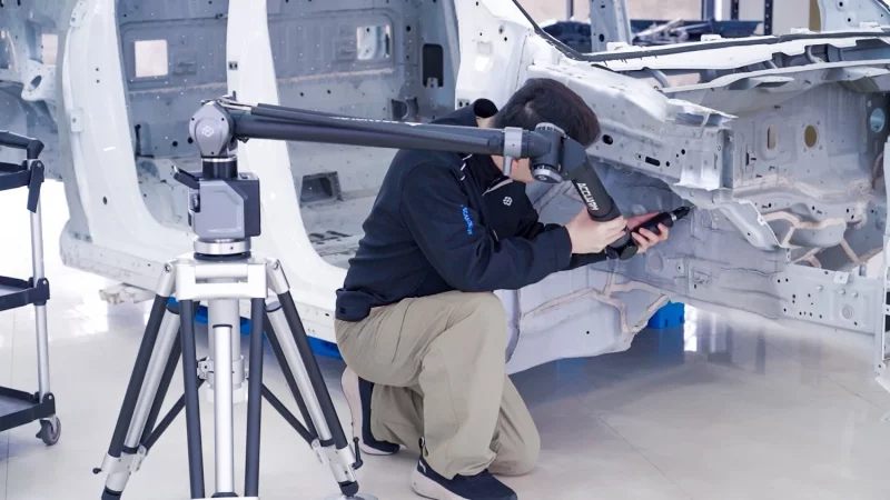

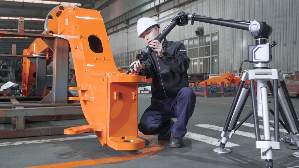

Portable Measurement for Production Environments
As manufacturing operations increasingly require in-process verification and rapid inspection of large or complex components, portable metrology solutions are becoming an important complement to traditional CMM systems. The AccuArm has been designed to address these requirements by enabling measurements to be performed directly at the point of manufacture or assembly.
The system features an aerospace-grade carbon-fibre arm structure, precision encoders, and high-accuracy bearings to provide stable measurement performance in industrial environments. SCANOLOGY reports that the AccuArm is certified to ISO 10360-12, the international standard governing acceptance and reverification tests for articulated arm coordinate measuring systems.
To maintain measurement consistency under varying environmental conditions, the system incorporates several compensation technologies, including automated thermal compensation for both the measuring arm and workpiece, force compensation to account for probe contact variations, and multi-frame optimization algorithms designed to reduce random measurement error and improve point accuracy.
Designed for Mobility and Ease of Use
Unlike fixed metrology systems that require parts to be transported to a dedicated inspection area, the AccuArm can be deployed directly on the shop floor, assembly line, or in-field environment.
The articulated arm incorporates a spring-assisted counterbalance mechanism intended to reduce operator fatigue during extended measurement sessions. Fast setup and single-operator deployment enable users to move the system between inspection locations with minimal downtime.
Additional mobility features include hot-swappable battery operation, wireless data communication via a USB Wi-Fi module, and plug-and-play probe exchange without recalibration. Multiple mounting options, including tripods, magnetic bases, and vacuum fixtures, provide flexibility for different inspection scenarios.
The arm’s 360-degree joint rotation capability also allows access to difficult-to-reach measurement locations while reducing the need for repeated repositioning.
