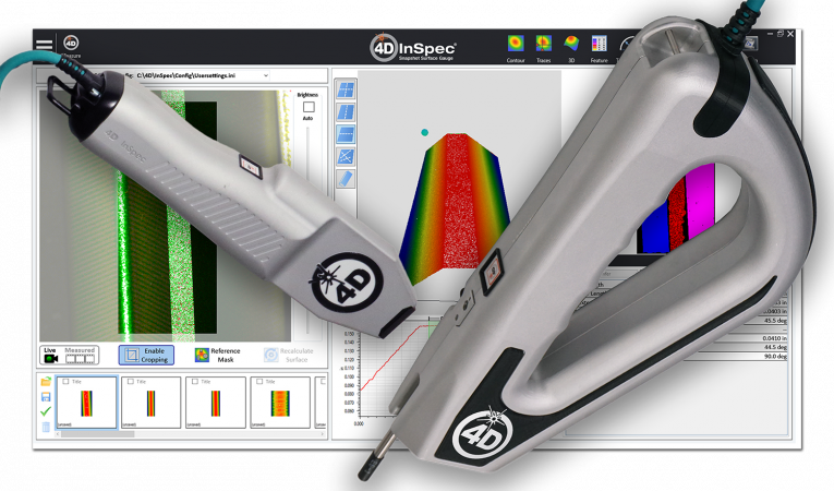

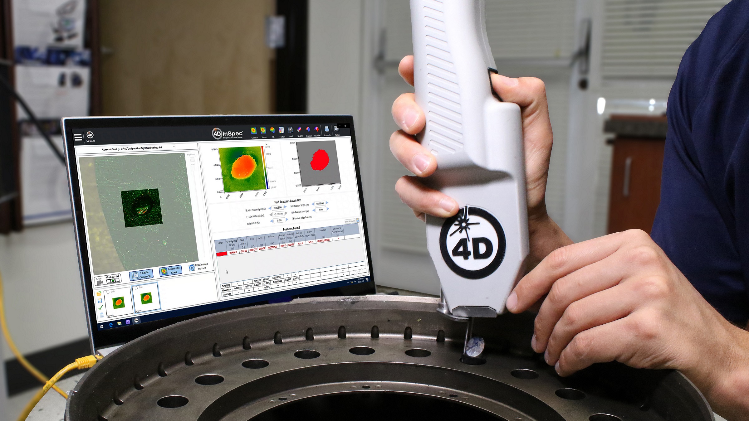

Kitov’s brightfield technology supports macro inspection with a field of view up to 77 mm x 93 mm and 5 MP resolution. 4D Technology’s 4Di InSpec 3D optical gauge supports micro defect and feature inspection with an 8 mm x 8 mm field of view, 4 MP resolution, and 2 µm Z resolution.
