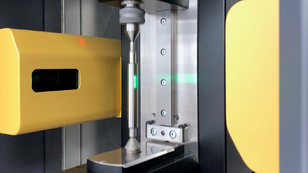

Used by quality personnel, machine operatives completing first-off checks, as well as the engineering team for samples and R&D, the Sylvac Scan F60L is designed to measure even the most demanding of cylindrical parts.
With a brand-new camera and optics offering superior image processing and fast inspection times, the optical measurement machine uses Reflex One-Click technology with part recognition and auto measure, allowing measurement with one click of a button. Quick-release tooling for making rapid part changeovers, combined with sophisticated software delivers immediate visual results, assisting in providing essential efficiencies in a busy working environment.
Boasting a small footprint that fits perfectly within the new inspection lab, the Sylvac scanner is used daily as part of the standard inspection procedure at Boneham & Turner. Primarily measuring a range of micro-pins that start at approximately 1mm diameter and 3mm long, the F60L has been praised for its ease of use and simple learning process amongst the team whilst proving to be an extremely precise piece of inspection kit for the company.
