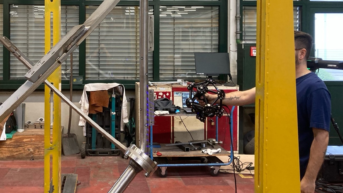

The MetraSCAN BLACK+|Elite 3D scanner can be used to acquire reliable and repeatable 3D measurements—right on the production floor.
