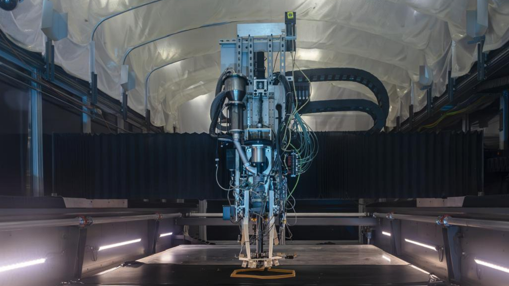

To test this, the team first calibrated the control system and adjusted the tight crown of six thermal cameras on the robotic nozzle. The assembly resembles a column of metal tubes laced with colorful wires suspended inside a printer the size of a boxcar. Researchers prepared to monitor how reducing print speed would affect the temperature of the layers. As each layer of plastic was dispensed, the print bed—serving as the floor—lowered slightly to make room for each new layer.
The machine printed a hexagon bigger than a truck tire to demonstrate the controller’s performance on a full-scale part. The job started with a low print speed to challenge the new controller. This resulted in material that was about 30% too cool when the next layer was applied. Detecting this, the controller automatically increased the print speed to maintain the best temperature for layers to fuse correctly, demonstrating real-time correction in action.
