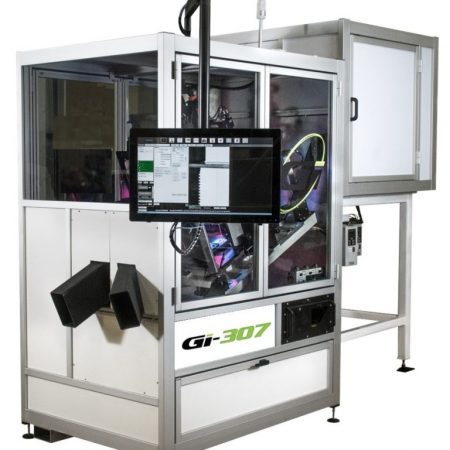

General Inspection has announced the launch of the Gi-307, a powerful new fastener inspection and sorting platform designed to redefine quality control for manufacturers producing mission-critical screws and bolts.

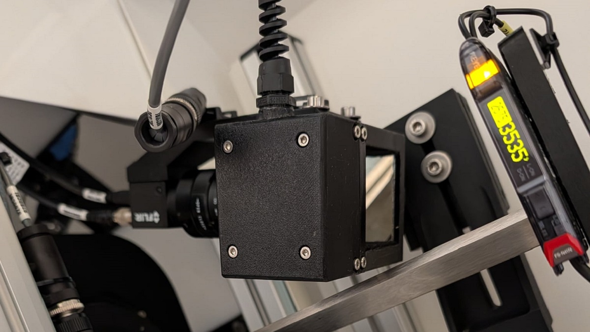

Built for applications where failure is not an option, the Gi-307 delivers comprehensive 360-degree inspection using a revolutionary combination of sequenced front and back lighting with seven high-speed inspection cameras. Unlike conventional inspection systems that struggle to balance dimensional accuracy with reliable surface defect detection, the Gi-307 performs both simultaneously — at production speeds up to 300 parts per minute.

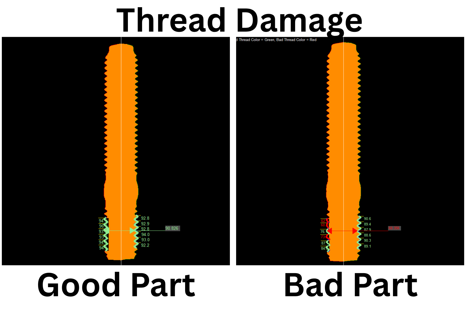

The system inspects every critical fastener feature, including threads, diameters, lengths, angles, radii, and straightness, while also detecting challenging visual defects such as cracks, plating failures, corrosion, metal chips, and porosity.
