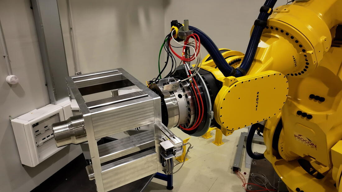

ITER engineers are also equipping assembly and maintenance robots with tactile feedback. Working with German measurement technology company HBK, ITER is developing specialized force-torque sensors that allow robotic systems to detect contact forces while manipulating shield blocks and first-wall components.
“These sensors are able to provide a sense of touch,” company representative Tim Ahlswede said during the workshop.
The sensors help the robot control system determine when a component has touched another surface, avoiding damaging collisions and adjusting the motion of the long robotic arm that extends into the vessel, according to Ahlswede. “When a heavy object is attached to a long arm it bends slightly, like a fishing rod when a fish is caught.”

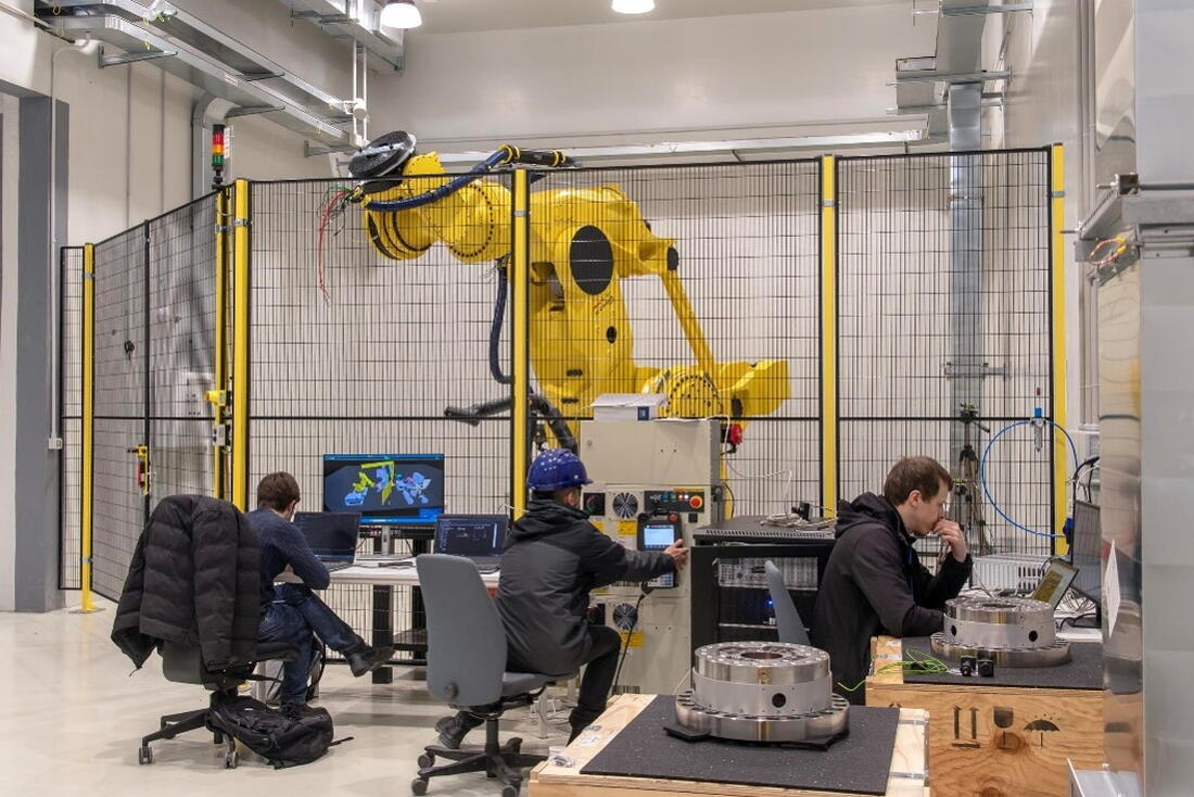

In the basement of the Tokamak Assembly Preparation Building, operators are busy calibrating the Godzilla robot. The force and torque sensors seen on the tables (bottom right) will be tested on the end of Godzilla’s robotic arm.
Without force sensing, releasing the heavy load could trigger dangerous movement throughout the structure. The sensors allow the control system to gradually reduce tension from the payload before disengagement, minimizing vibration and improving positional stability inside the vessel.
Fusion environments also impose unusual engineering requirements on the sensors themselves. One of the biggest challenges for the HBK team was ensuring the systems could tolerate radiation exposure while still maintaining precise measurement performance. The company tested specialized strain gauges, cabling and materials at irradiation facilities before selecting suitable components. ITER’s seismic requirements added another layer of complexity, requiring the sensors to tolerate loads far beyond normal operating conditions.
