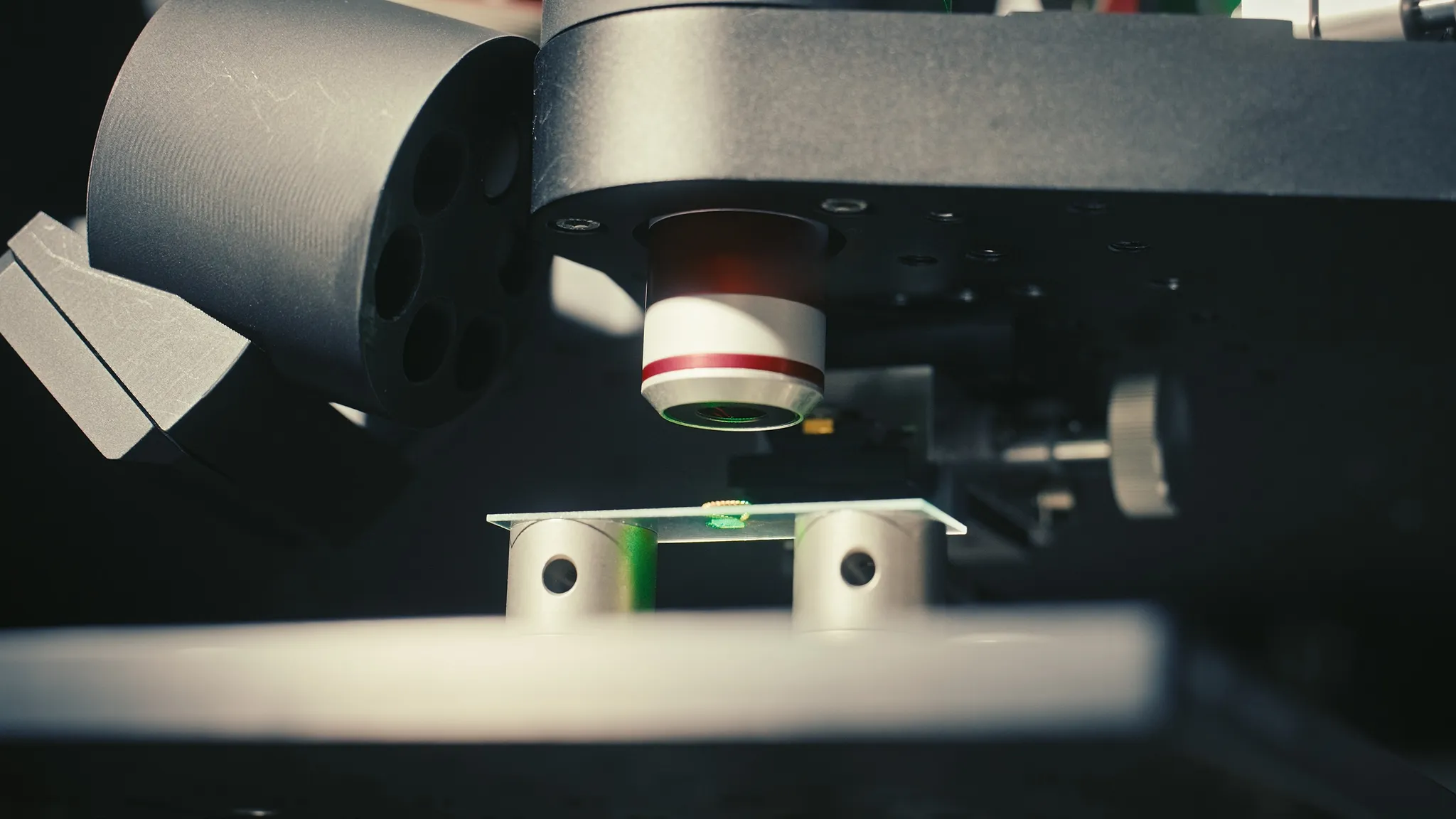

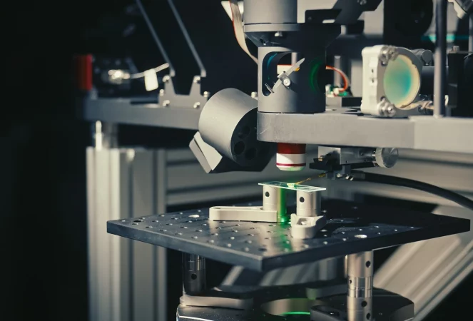

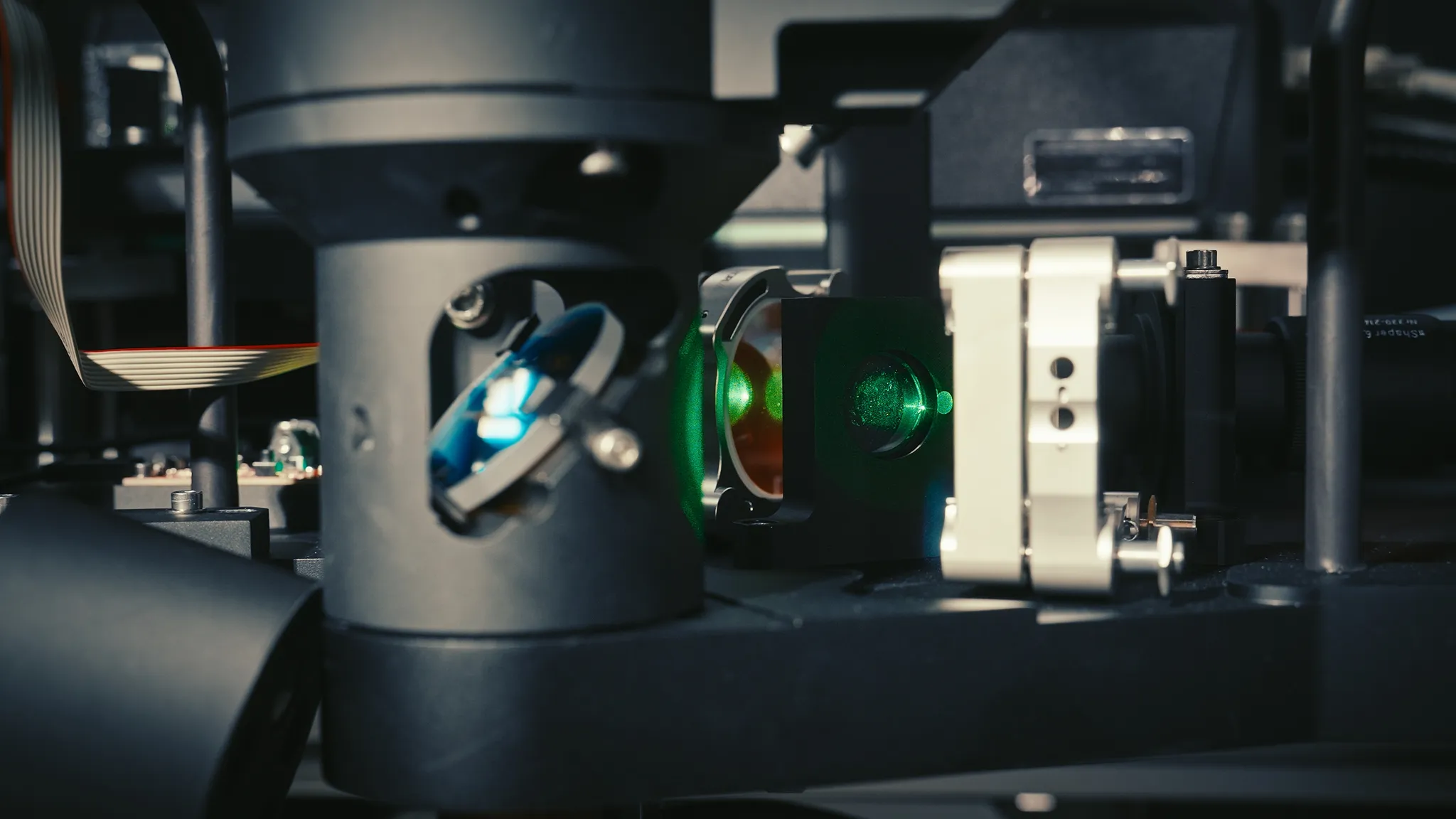

The sensing mechanism depends on a specific defect in synthetic diamond. Nitrogen-vacancy (NV) centers are atomic-scale defects intentionally created in a thin layer of laboratory-grown diamond. Each NV center acts as an extremely sensitive local magnetometer: its quantum state shifts measurably in response to the magnetic field at its location. Illuminating the NV layer with a green laser and reading out the resulting optical signal recovers a spatially resolved magnetic field map across the entire field of view simultaneously, a widefield image rather than a point-by-point scan. QDm comes with all the advantages of optical imaging: resolution, speed and ease of use, without requiring optical access to the defect location.
In operation, the synthetic diamond sensor chip is placed against the surface of the device under test. A bias current is applied, replicating the conditions under which the failure is observed, and the instrument acquires a full magnetic field map of the package beneath. A current reconstruction step converts that magnetic map into a two-dimensional current density image, showing which conductors are carrying current and which are not. The output overlays directly onto the chip’s layout database, allowing the engineer to identify immediately which interconnect, TSV, or microbump is anomalous. The measurement requires no vacuum, no cryogenic cooling, no sample preparation, and no mechanical modification of the device. The chip goes in, the measurement runs in seconds to minutes, and the chip comes out intact.

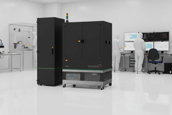

QuantumDiamonds has commercialized QDM as the QDm.1, the first integrated quantum sensing system designed for semiconductor failure analysis. The system is now in active deployment at leading failure analysis laboratories in Europe, Asia, and, following the company’s first North American installation at Eurofins EAG Laboratories in Sunnyvale. They are part of the growing recognition of NV-diamond magnetic imaging as an important semiconductor characterization technique, which is reflected in peer-reviewed literature, conference programs, and emerging commercial activity.
The product roadmap extends the technique progressively closer to the production line. The current InLab configuration is positioned as a failure analysis and process debug tool. An InFab configuration targeted for 2027 is designed for lot-level defect metrology at advanced packaging lines with throughput compatible with sampling inspection. An InLine wafer-level configuration, targeted for 2028, aims to enable 100%, non-contact, in-line current mapping at key assembly process steps. The trajectory follows a path familiar from the history of semiconductor metrology: a technique that begins in the failure analysis laboratory migrates toward the production line as throughput improves and the economic case for in-line deployment becomes compelling.
