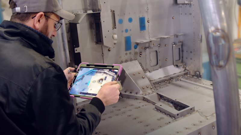

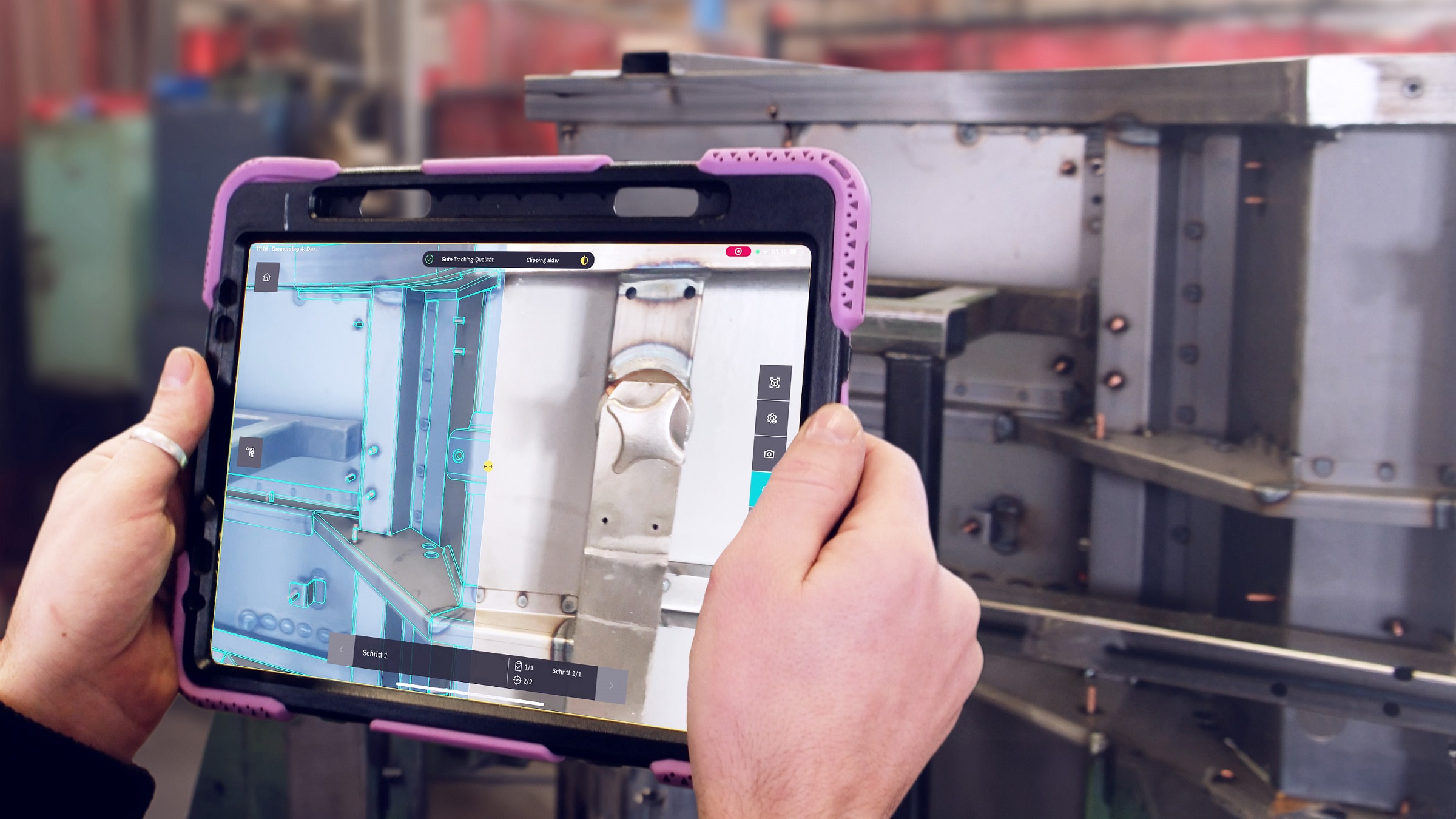

Within WISAG’s production environment, Twyn functions as a rapid nominal-versus-actual comparison tool. The AR platform enables operators to quickly determine whether assemblies are complete and correctly aligned before they move to subsequent production stages.
Rather than replacing conventional metrology systems, Twyn complements traditional measurement methods by acting as a fast visual screening tool. Detailed metrology inspections are only performed when the AR platform identifies a deviation. If Twyn confirms that the assembly is within specification, components can proceed immediately to the next manufacturing step without additional inspection delays.
This approach significantly reduces the need to transport large assemblies to dedicated quality inspection areas, simplifying internal factory logistics while reducing inspection time and operational costs.

The AR platform is also helping accelerate employee onboarding and training. Traditionally, identifying and interpreting assembly defects required significant experience and expertise. Twyn shortens this learning curve by visually highlighting deviations, making defects easier to detect even for less experienced operators.
“Features such as the split-screen display and magnification function on the tablet are especially valuable for our work,” said Duphorn.
By guiding operators visually through inspection procedures, the platform also contributes to greater process consistency and reduced dependency on specialist knowledge.
