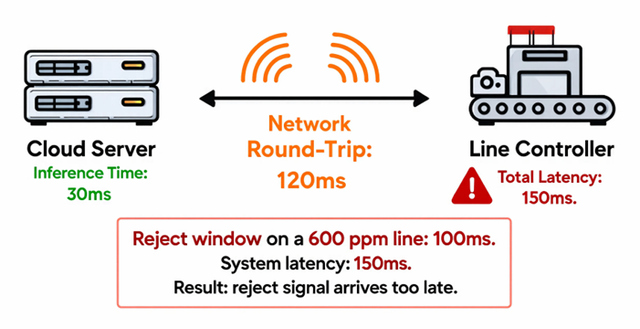

The Latency Problem: What the Spec Sheet Leaves Out
Most cloud AI vendors quote model inference time, which is the time the model takes to process an image once it arrives at the server. This number can look very competitive, often under 50 milliseconds. What that figure does not include is network latency, which in a real factory environment can add anywhere from 20ms to 300ms depending on network congestion, distance to the cloud server, and packet loss.
On a high-speed production line running 600 parts per minute, each part occupies its inspection window for 100 milliseconds. If your total system latency, model inference plus network round trip, exceeds that window, you cannot reliably trigger the reject mechanism for the correct part. You will either miss rejects or false-reject the wrong part.
A cloud system with 30ms inference time and 120ms average network round-trip has a total latency of 150ms. On a 600 ppm line, that system cannot reliably reject defective parts. The spec sheet shows 30ms. The production floor sees 150ms.
Edge AI eliminates network latency from the equation entirely. With inference running locally on optimised hardware, total system latency can be held under 20ms regardless of what is happening on the factory network.

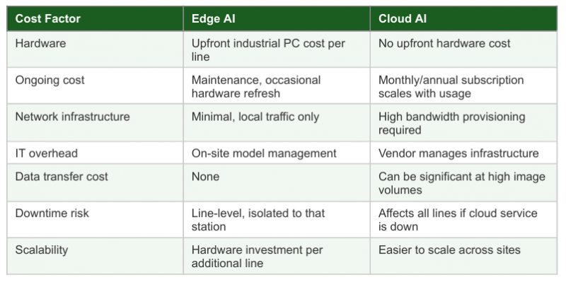

Total Cost of Ownership: The Comparison That Actually Matters
For a single high-speed line, edge AI typically reaches cost parity with cloud within 18 to 24 months when subscription fees and bandwidth costs are modelled honestly. For multi-line deployments at a single site, edge infrastructure costs are partially shared, improving the economics further. For multi-site deployments with low-speed lines, cloud can remain cost-competitive over the same period.
