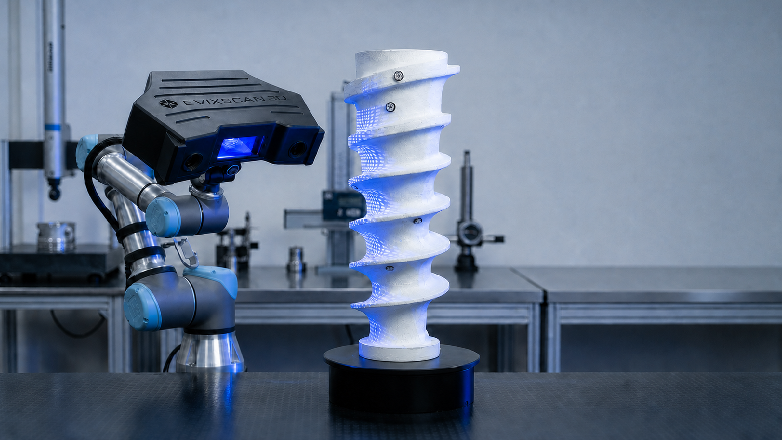

The initial digitization phase utilized the eviXscan3D Quadro+ scanner together with eviXscan3D Suite software. Magnetic geodesic markers, a rotary table, and automated scanning routines enabled efficient acquisition of the auger’s complex geometry.
From a metrology perspective, several factors were particularly important.
Reliable Alignment of Complex Helical Geometry
Helical components can be challenging to scan because their repetitive features may confuse alignment algorithms. Geodesic markers provided stable reference points throughout the acquisition process, reducing the risk of registration errors and cumulative alignment drift.
Automated and Repeatable Data Capture
The use of a rotary table ensured consistent positioning and viewing angles throughout the scanning process. This not only accelerated acquisition but also improved repeatability and data quality.
