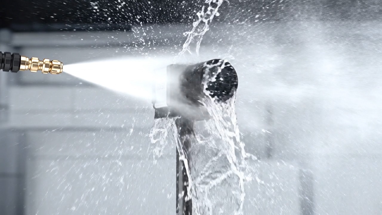

When production systems are cleaned using high-pressure jets, operate in dusty environments or are exposed to sub-zero temperatures, particularly robust machine vision solutions are required. The uEye FA series from IDS Imaging Development Systems GmbH has been specifically designed for such demanding environments, featuring IP69K protection. The expanded uEye FA series adds models with 2 to 12.5 MP Sony STARVIS 2 sensors, combining rugged protection with high image quality for industrial automation and inspection tasks.
This provides users with high-performance cameras for a wide range of industrial applications with varying lighting conditions – from manufacturing automation to quality inspection. The new models incorporate sensor variants IMX662 (2 MP), IMX664 (4 MP), IMX675 (5 MP), IMX678 (8 MP) and IMX676 (12.5 MP). Allare GigE Vision-compliant, allowing easy integration into existing systems.
The Sony STARVIS 2 sensors impress with their exceptional light sensitivity extending into the near-infrared (NIR) range, very low noise levels, and the Clear HDR process for an expanded dynamic range. This enables the capture of detailed, sharp images even in demanding environmental conditions. An asynchronous exposure trigger further enhances their suitability for industrial use.
The camera hardware itself has also been specifically designed for industrial applications: Thanks to the IP69K-protected housing, lens tube and corresponding cabling, the cameras operate reliably even under high pressure, heavy contamination or temperatures down to –20°C.
