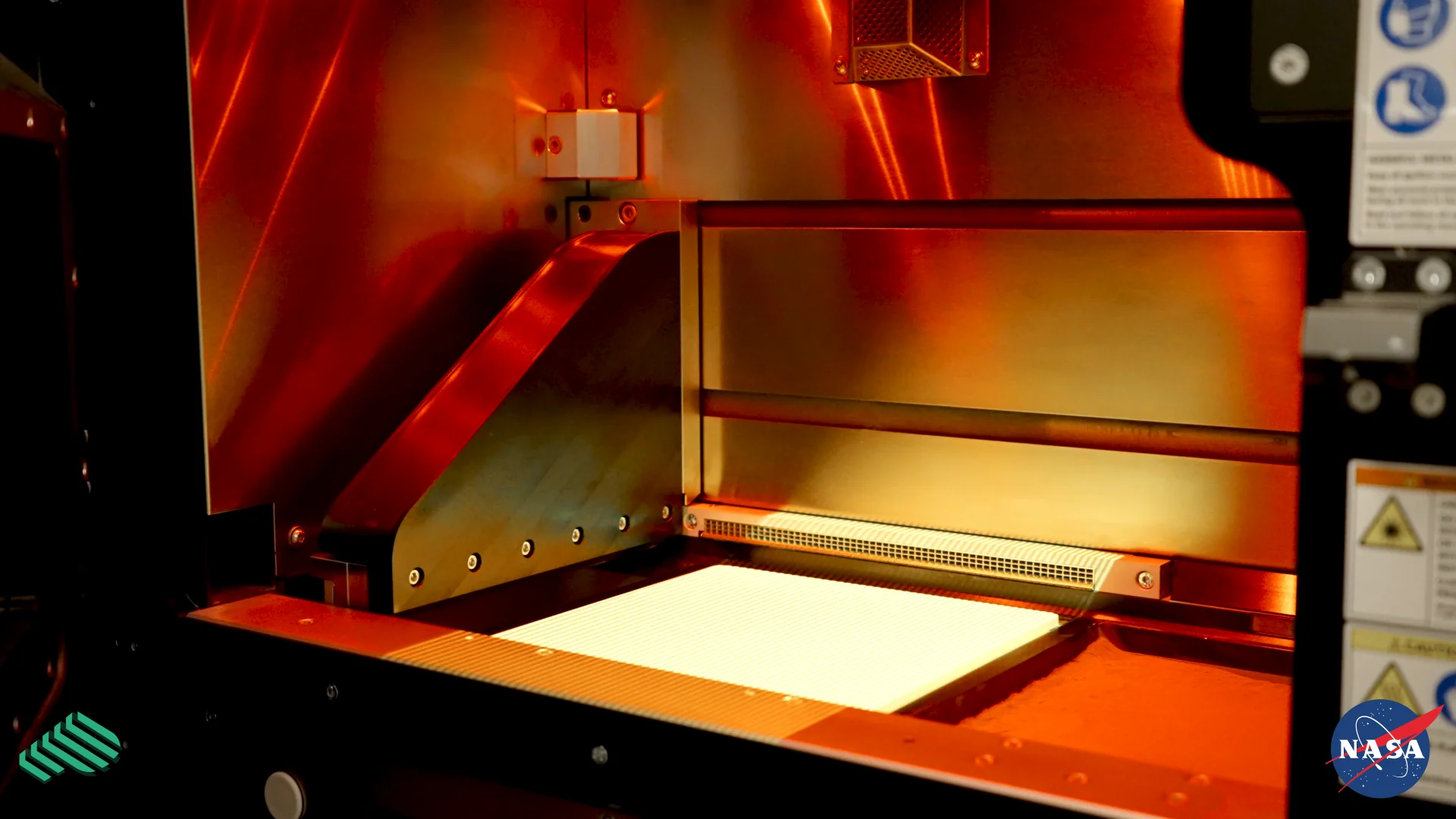

Phase3D’s Fringe Inspection system uses structured light projection to generate calibrated three-dimensional height measurements throughout the laser powder bed fusion process.
After each powder layer is deposited and following laser exposure, the system projects structured green light across the build surface and captures high-resolution measurements of the layer geometry.
Rather than producing visualisations alone, Fringe Inspection generates metrology-grade measurements that can be compared quantitatively throughout the build.
