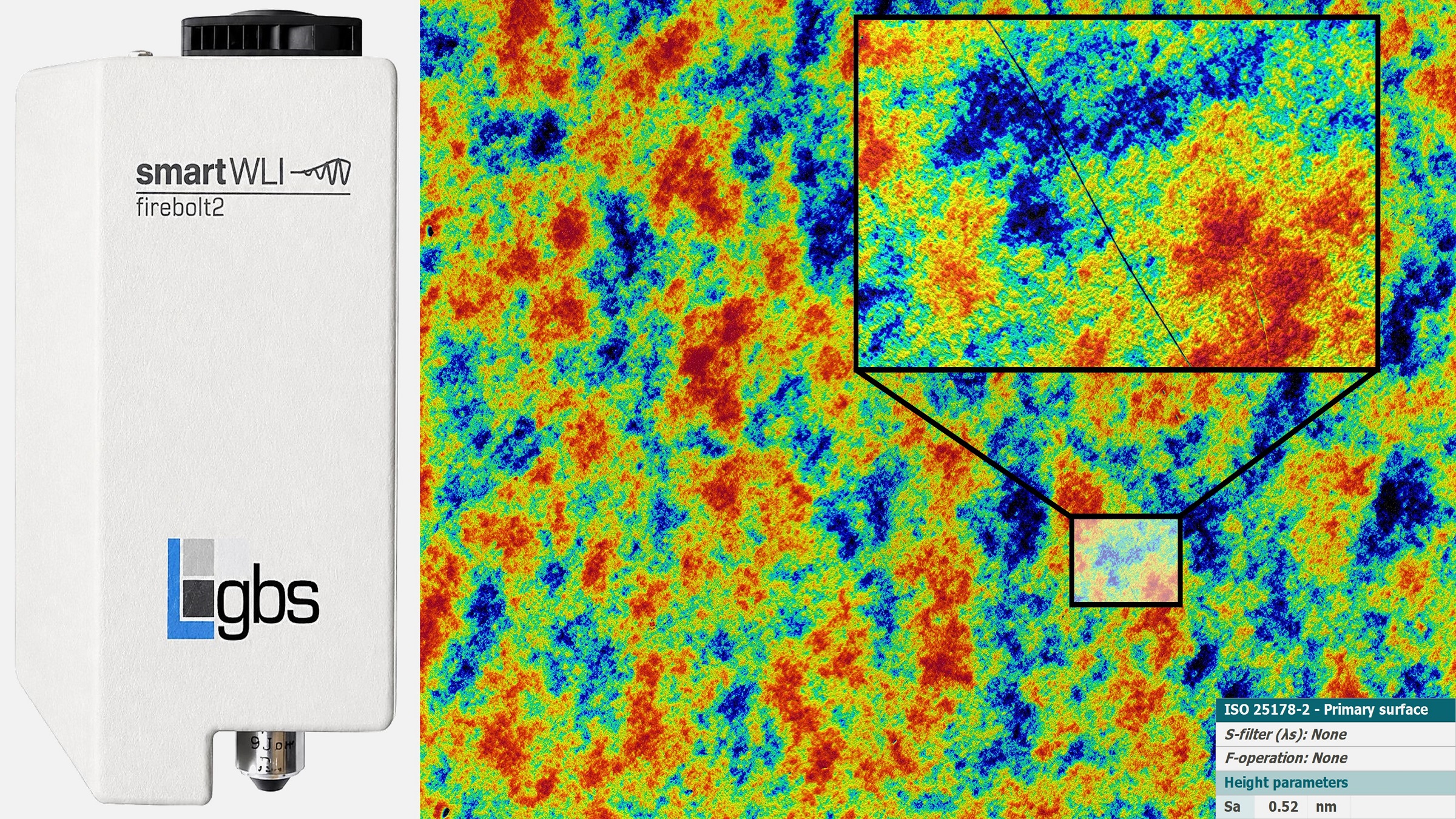

GBS Metrology has introduced the smartWLI firebolt2, a high-speed, high-resolution optical 3D sensor for non-contact surface measurement. Based on white-light interferometry, also known as coherence scanning interferometry, the sensor operates at up to 2.57 kfps with a resolution of 2.4 megapixels.
The smartWLI firebolt2 uses a PCIe high-speed camera to acquire the large number of images required for fast 3D surface measurement. As the resulting data volumes can challenge even modern graphics processing hardware, GBS Metrology has redeveloped the sensorโ€™s internal data-processing architecture.
The new processing system handles a data rate approximately five times higher than that of the fastest 10 GigE cameras previously used, while retaining the central functions of the smartWLI product family:

3D Surface Measurement of Roughness and Steep Microgeometries
The smartWLI firebolt2 supports a wide range of optical surface metrology applications. It can characterize extremely low surface roughness extending into the sub-angstrom range while also measuring steep microgeometries, including cutting edges on precision tools.
