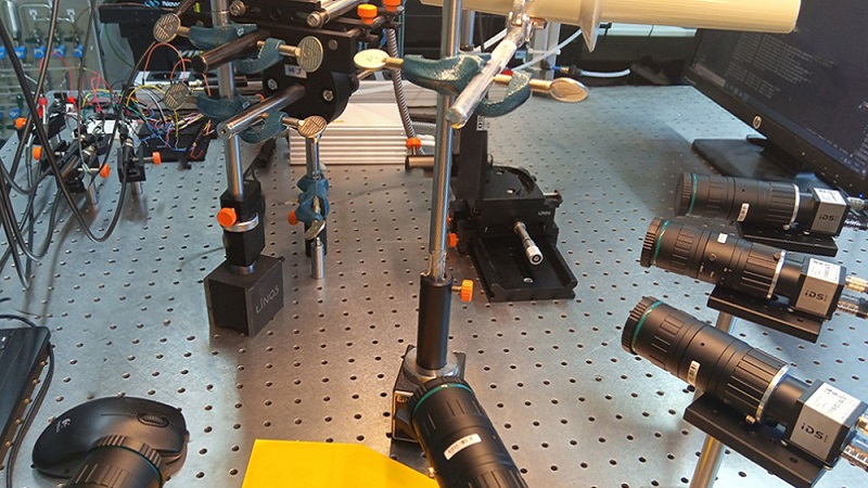

Calibration of the multi-camera setup on the kINPen using a 3D-printed reference object.

Multi-View Stereo For 3D Reconstruction
To experimentally characterise the spatial structure of the plasma discharge, the INP employs a multi-view stereo approach using five IDS cameras operating in synchronisation. The plasma discharge is captured from different angles at the same time. In addition to precise calibration of the camera system, a key requirement for a robust spatial reconstruction is the reproduction of the fine discharge structures with as little distortion as possible.
High‑aperture 75 mm lenses from IDS are used, featuring a large 1.2‑inch image circle and an f/2.8 aperture. This optical performance is required because the discharge has an axial length of less than 10 mm and a width of less than 1 mm.
“At an observation distance of around 500 mm, the plasma filament is hardly self‑luminous; its brightness is almost comparable to that of a firefly,” explains Dr‑Ing. Philipp Mattern, supervisor and examiner of the master’s thesis conducted at INP. “It is only the combination of the sensor and the optics that enables high quality images to be captured despite exposure times of just a few microseconds.”

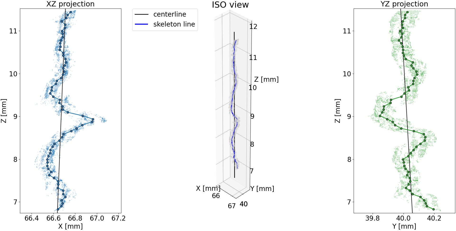

During image analysis, distinctive structures within the plasma discharge are identified and used as cross image point correspondences, from which the three-dimensional structure of the discharge is reconstructed as a point cloud.
“The point clouds obtained in this way provide, for the first time, a reliable basis for investigating the discharge paths,” explains Artur Wittig. “This allows us not only to visualise the plasma structure, but also to analyse it systematically.”
Camera Selection With Focus on Triggering and Synchronisation
The image processing task is handled by five industrial cameras of the uEye CP U3‑31J0CP Rev.  2.2 type from IDS, which are well suited for parallel operation in multi‑camera setups thanks to their triggering and synchronisation capabilities.
The conceptual foundation for this setup, as well as the decision to use IDS hardware, was the brainchild of Dr Philipp Mattern. Some aspects of the scientific and technical support were provided through his engineering firm, M.E.S.S. (Mattern Engineering & Software Solutions). “Based on my experience with similar applications, it was clear that this camera system would be able to meet the high optical and temporal requirements,” explains Mattern.
The main factors influencing the choice were the capabilities for precise hardware triggering, exact synchronisation and the ability to reliably control very short exposure times. Due to the highly dynamic nature of the plasma discharge, precise triggering, exact synchronisation and reproducible exposure times in the microsecond range are crucial for capturing the same features in every image. The global shutter sensor used enables distortion-free imaging of the short-lived plasma structure and ensures stable image quality even at exposure times in the microsecond range.
The camera is equipped with a square Sony Pregius S CMOS sensor (IMX546) and offers a resolution of 8.13 megapixels. The combination of a global shutter and backside illumination (BSI) enables short exposure times even in low-light conditions – a key requirement for the reliable imaging of self-luminous, short-lived plasma structures.
“The comprehensive documentation provided by IDS was also helpful, as was the technical support in designing and validating the configuration of multiple cameras for simultaneous image capture and the stable setup of the multi-camera system,” says Artur Wittig.
Integration is carried out via the IDS peak SDK, which enables the configuration and simultaneous operation of multiple cameras. The ability to reliably save and reuse camera settings ensures that experimental measurement series can be carried out under consistent conditions and compared with one another. The control and automation of the multi‑camera setup are carried out via the IDS peak API for Python, which conveniently enables parallel operation, triggering and image storage.
More Than Just Visualisation: Experimental Proof of Concept
The multi-camera methodology developed is not merely intended for illustrative purposes. Rather, it represents an experimental proof of concept: For the first time, it has been demonstrated that the highly dynamic plasma discharge of a kINPen jet can be reconstructed as a three-dimensional point cloud and subsequently analysed structurally. This provides a practical basis for further investigations into the spatial propagation of plasma jet discharges.
Structural analysis of the plasma discharge in a kINP jet
Furthermore, the method is not limited to kINPen, but can also be applied to other small discharge structures with relatively little effort.
