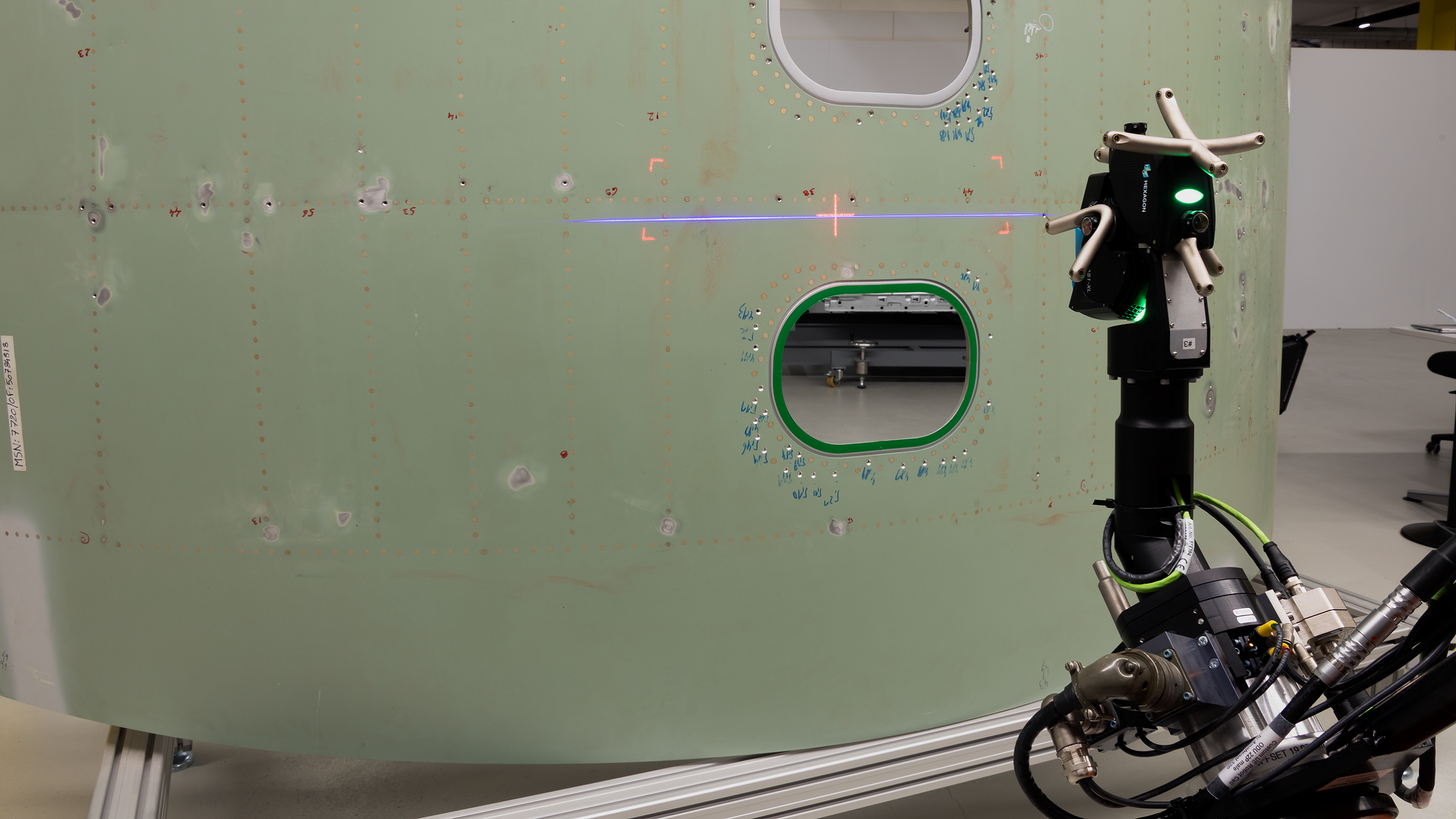

Hexagon is also introducing SARCA, a new robot-calibration device that uses multi-zone, multi-tool calibration to improve the accuracy of industrial robots by up to ten times. Used alongside SpatialAnalyzer, SARCA lets manufacturers calibrate robots for high-precision work before they go into production.
This release also enables full use of a new class of metrology device, the Leica Absolute Tracker ATS800, across room scanning, conventional laser position tracking with reflectors, and high-precision direct scanning of features. Support for the ATS800 is delivered through Hexagon’s revamped System Integrator Programme, which brings new metrology devices and capabilities to the systems that OEMs and integrators build.
