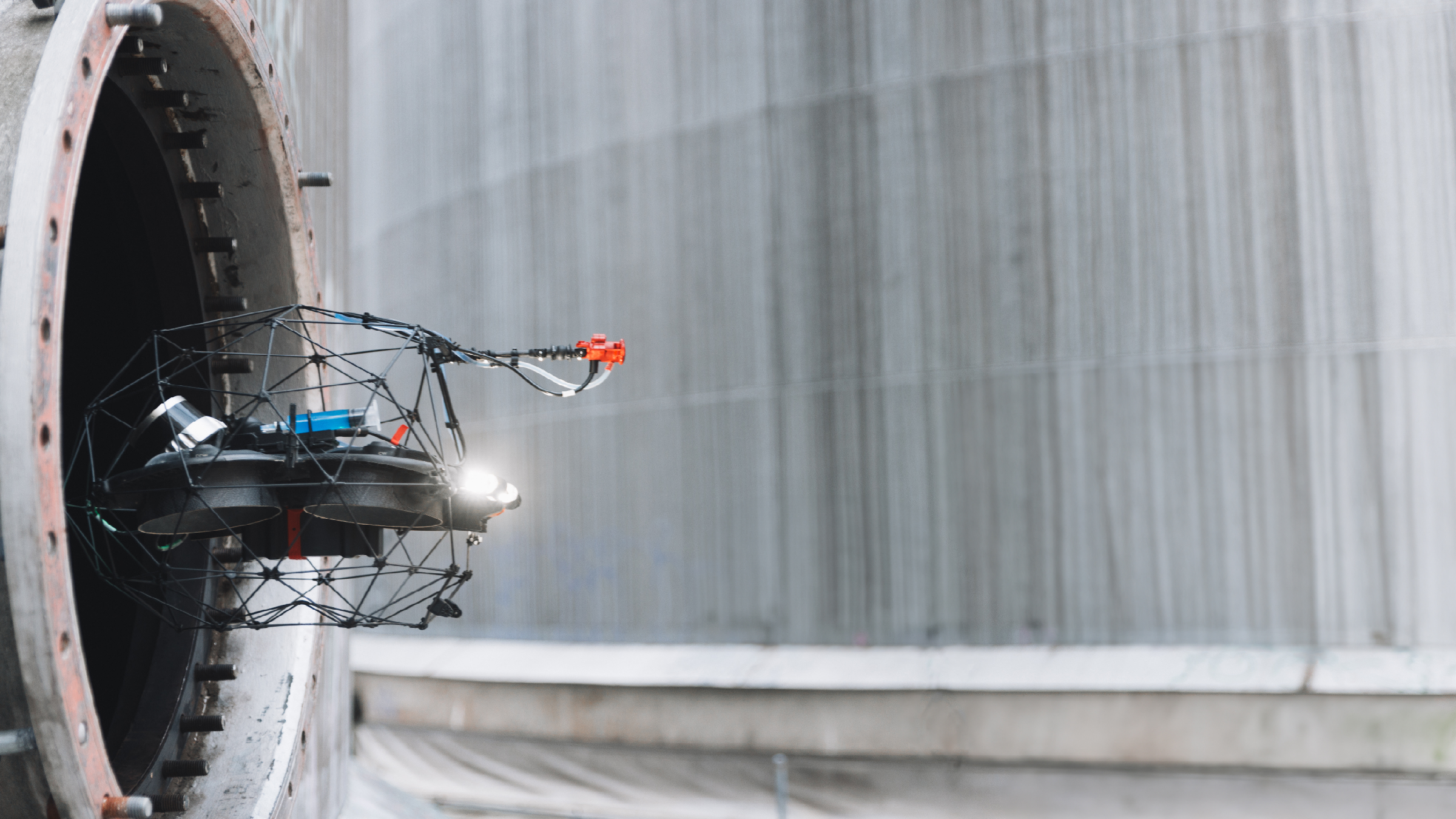

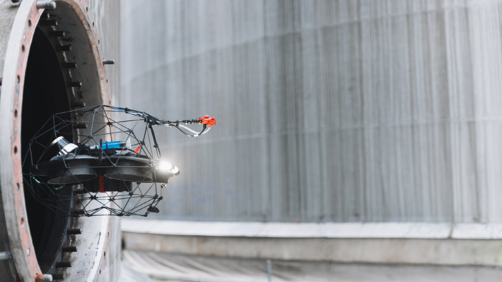

The new live A-scan UT payload is designed for spot thickness measurements of steel in ship hulls, inside tanks, and between pipe ranks amongst many other applications. With UT critical to many inspection processes, this new payload presents a safer means of accessing thickness measurement locations (TMLs). The Elios 3 can enter confined spaces or easily reach TML points at height, completing wall thickness gauging or corrosion surveys quickly and safely. The ultrasonic probe is mounted on a smart arm featuring a laser pointer that provides visual guidance to precisely aim at measurement points. The arm has mounting and shaping options that can adapt to the complexity of industrial settings. A remotely operated couplant dispenser ensures optimal ultrasound transmission to the material under test. Each measurement can be location-tagged on a digital twin of the asset for ease of analysis. The Elios 3 can also carry a cleaning module to prepare test surfaces for measurement.

Quality and standard compliance have been central to this payload’s development. Robotics specialists Flyability describe the partnership with Cygnus as instrumental to the integration and application of ultrasonic measuring technology with the Elios 3, resulting in a unique product tailored for challenging inspection environments. Software integration with the Elios 3’s piloting app Cockpit allows for real-time visualization of the live A-scan and manual adjustment of the gain and gates. A choice of twin crystal piezo-electric composite transducers supporting through-coating echo-echo measurement mode is available. Benefitting from Cygnus’s 40-year experience in UT markets, the payload empowers operations under ISO 16809 compliance and meets the highest standards of accuracy, quality, and reliability in thickness gauging.
