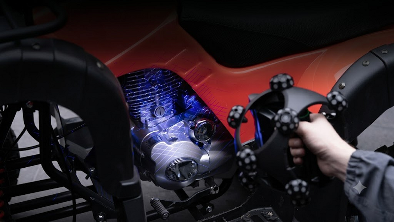

Trackit SR uses optical tracking technology to determine the scanner’s position in real time, removing the need to place reference markers on the part being measured. According to Revopoint, the system supports three laser scanning modes that can be selected depending on the inspection task:
Fine Mode – 30 blue cross laser lines for detailed scanning.
Far Mode – 17 blue parallel laser lines for capturing larger surfaces.
Deep Hole Mode – a single blue laser line for recessed features and cavities.
The company says the scanner can capture dark, reflective and metallic surfaces without requiring surface sprays or marker targets.
