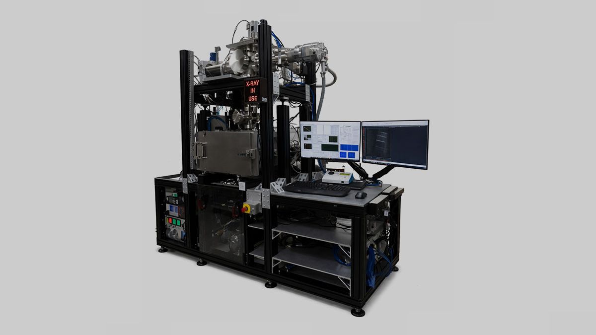

Short for Experimental X-ray CALIBration UseR facility, EXCALIBUR helps researchers inspect the thin films, coatings and foils used in X-ray systems. These materials can be thousands of times thinner than human hair or closer to the thickness of thin plastic, depending on how they are used. They act like specialized windows or filters that shape X-ray beams, let X-rays pass through, maintain vacuum seals and protect sensitive equipment.
To better understand how these materials will perform, EXCALIBUR brings together X-ray sources, precision detectors, X-ray cameras, automated instruments and advanced analysis tools into one compact setup. It can figure out what the materials are made of, how much X-ray energy passes through them and how much material there is, all without damaging the part. It also can inspect multiple spots on a single sample or measure dozens of samples in one day, giving researchers information that would otherwise be more difficult or time-consuming to obtain.
That level of detail is important because some thin-film and foil manufacturers allow thickness variations of 10% to 20%, which can affect how an experiment performs. By making these measurements faster and easier to obtain in a standard lab setting, EXCALIBUR helps improve the trust researchers have in their own materials and accelerates progress in areas such as fusion energy, plasma science, semiconductors, sensors and space technologies.
