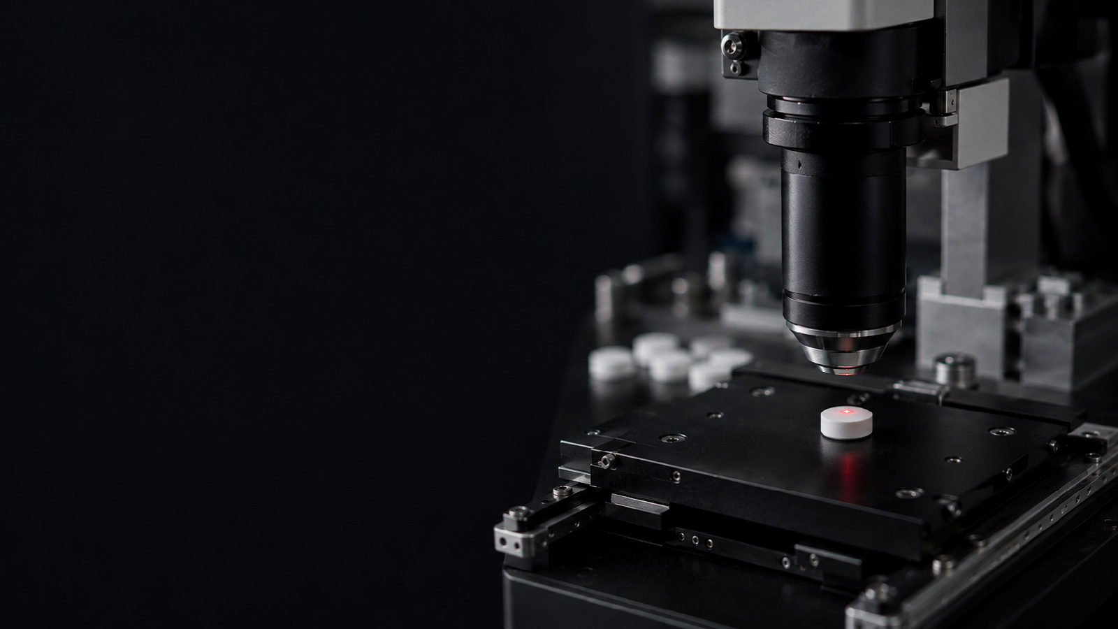

The team tested the platform on widely used active pharmaceutical ingredients, including indomethacin, ibuprofen, and paracetamol. It distinguished between amorphous forms of the same drug produced by different manufacturing routes, a distinction conventional methods often cannot resolve, and mapped the mechanical, structural, and chemical makeup across an ibuprofen tablet.
